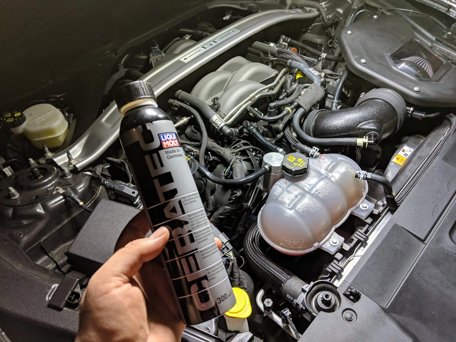

Just an update on my situation:
I took the mustang for a 60 mile round trip yesterday. That involved 2 cold starts. On both startups, the engine didn't exhibit tick, but when the car started to warm up a little and the idle rev comes down to around 800-1k rpm, the ticks start to come in. It seems to be a resonance thing?
Anyway, tonight I decided to go ahead and pour in the ceratec (half recommended dose, which is 1 can). Results?
As I suspected from the countless examples on Youtube, the tick reduced to an almost inaudible 1/10th of the previous tick right away and the engine overall sounded much 'smoother'. I only ran the car for about 5 minutes, so didn't give it enough time for the tick to vanish altogether. You have to listen quite carefully with the exhaust on 'quiet' to hear it though and I have very good ears! I'll run the car around tomorrow and keep monitoring it, but for now I'm very happy with the results. I'll report back in a day or so. It may well be that the engine always had a very quiet tick, but it wasn't pronounced enough for anyone to ever notice.
Video of revs around 800-1k after adding Ceratec:
