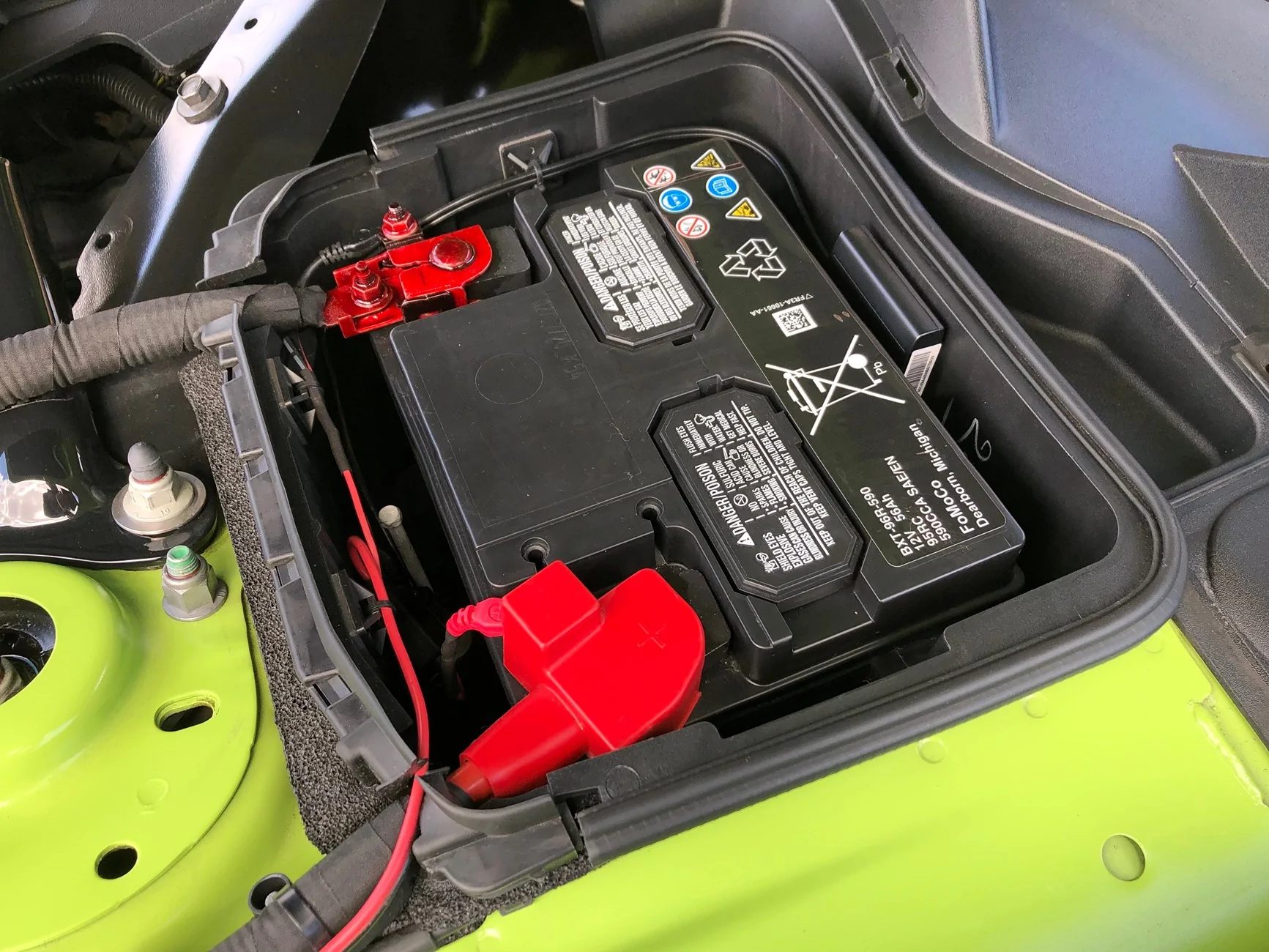

Lime GT
lol…all these experts, and nobody talks about the 8 hour self-resetting BMS šŸ˜‰
Who Leaves a tender on for less than 8 hours anyway ?
I’m absolutely with you, I just gave up quoting it and resorted to mild sarcasm … lol
I’m also still on my original battery but please don’t listen to me, I can’t even connect my tender properly … :facepalm:
Taken last month :
I only pulled the cover to clean the drain and check the battery terminals hadn’t disintegrated.
WD :like:
