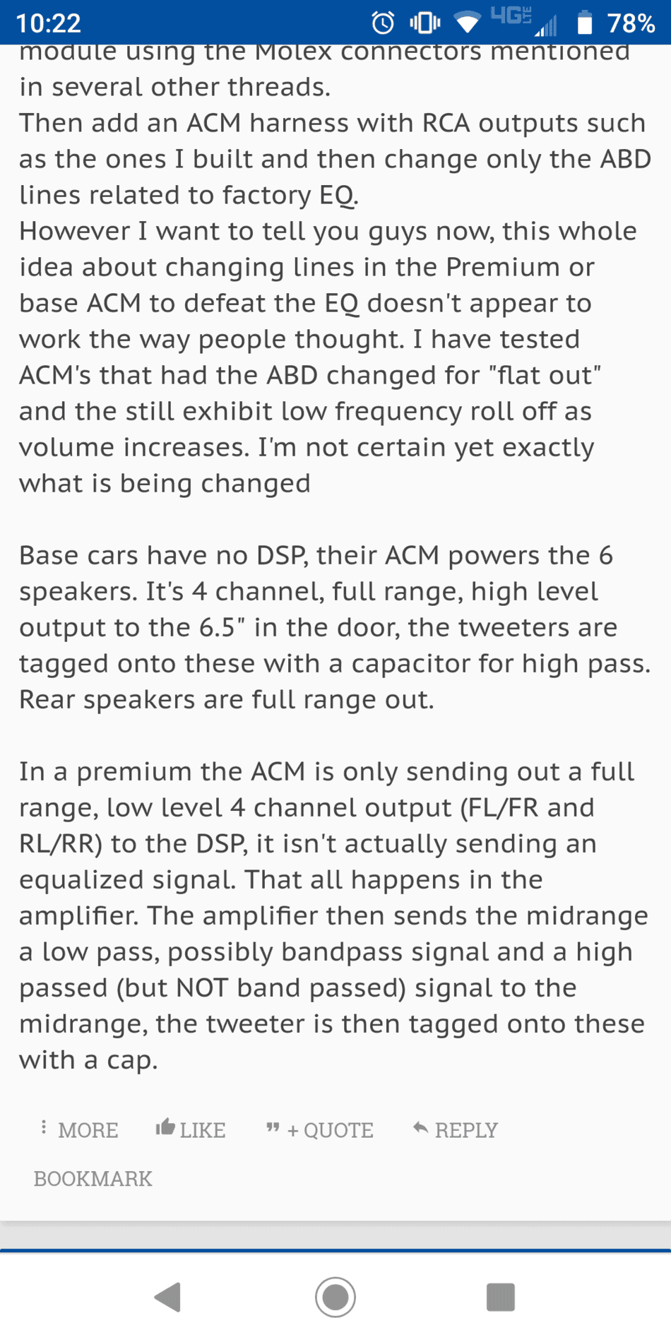

I tried to find the post where I took this screen shot but couldn't.
