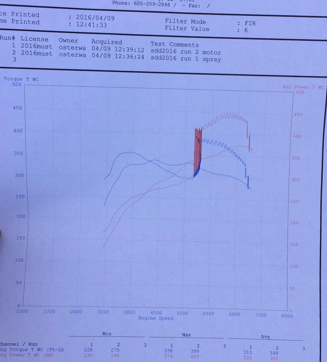

I got my tunes finally. The car doesn't want to run on their 93"race" tune. It surges and feels down on power. The e85 tune is way way fat. Car has afr's of 5.0 and 5.5. When with e85 that's super rich. I spoke with them and they may have sent my tunes out with the wrong I injector data. The person on the phone is unable to look at the tune they send you and see what was going on with it. I have another set of injectors coming and at cai. So we will see how it turns out.
