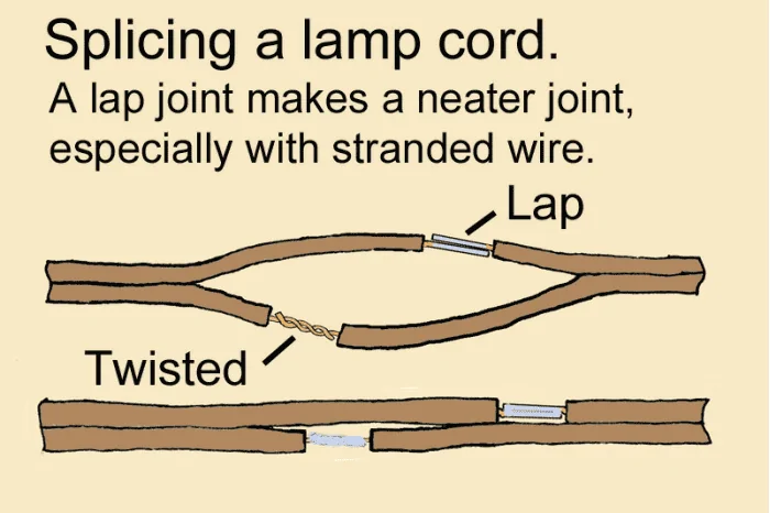

My main hesitation is that I've never really done it, I guess I'd just cut out a piece of this harness - line up the wiring and twist them together with some sort of covering?
few different splice methods but I would use simple lap splice and solder and each wire and cover with heat shrink, then wrap entire bundle with cloth electrical tape for oem look. Picture below gives idea of simple lap splice and 2nd pic gives you example of offsetting the wires.
