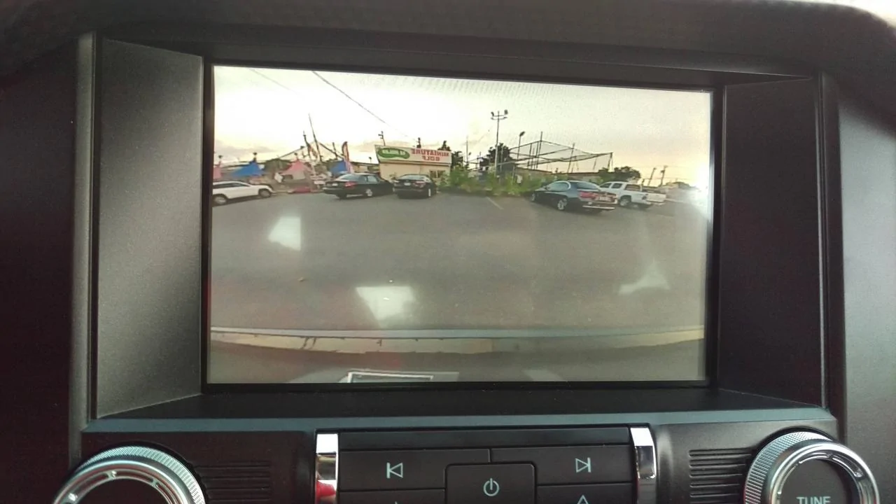

Here is my view, most of the time it shows the warning text up top.

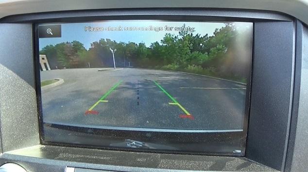

Found this pic on google. You can see the zoom icon in the upper left corner. Looks like you need to take it back to the dealership. Have you tried driving above 12 mph as mentioned above? I looked, but didn't see that actually mentioned in the manual.
yes, and i dont think mine ever had that icon or i just never noticed it. I unplugged the battery and drove it for ~20 minutes after on the highway doing 60mph plus.
I can try this again and time the battery being unplugged for 30+ minutes and drive it again. The manual is vague in that it does not say how long it needs to be driven.
