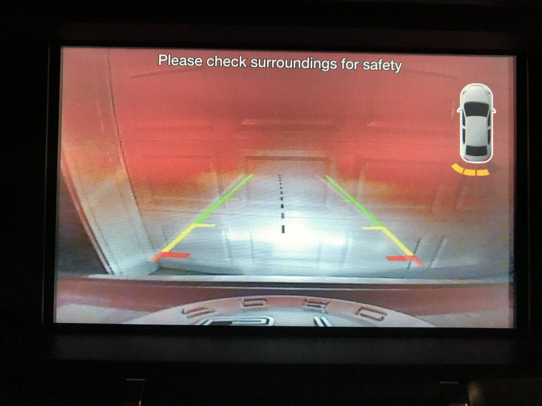

I tried going through all the settings on the screen and still no luck. I wonder if it's a fuse or a broken wire in the trunk harness. I have no visible sensors on the bumper cover. At this point I am stumped

Sound is turned up. It appears that it was a option for the car that was never installed. there are no sensors on the bumper cover.After spending 3 hours checking settings,trunk harness,fuses,back up lights etc.........No back up audio was installed from factory........
