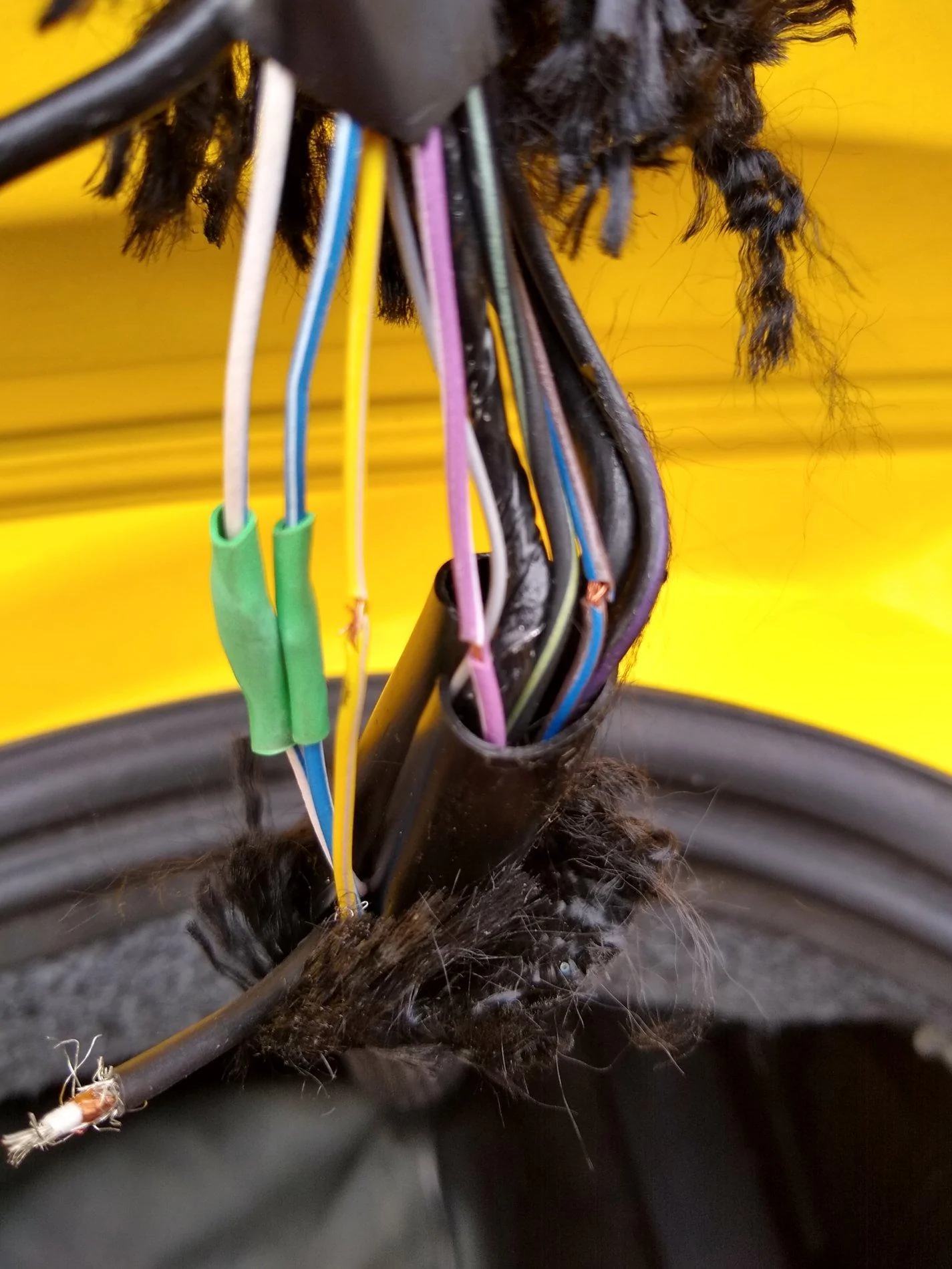

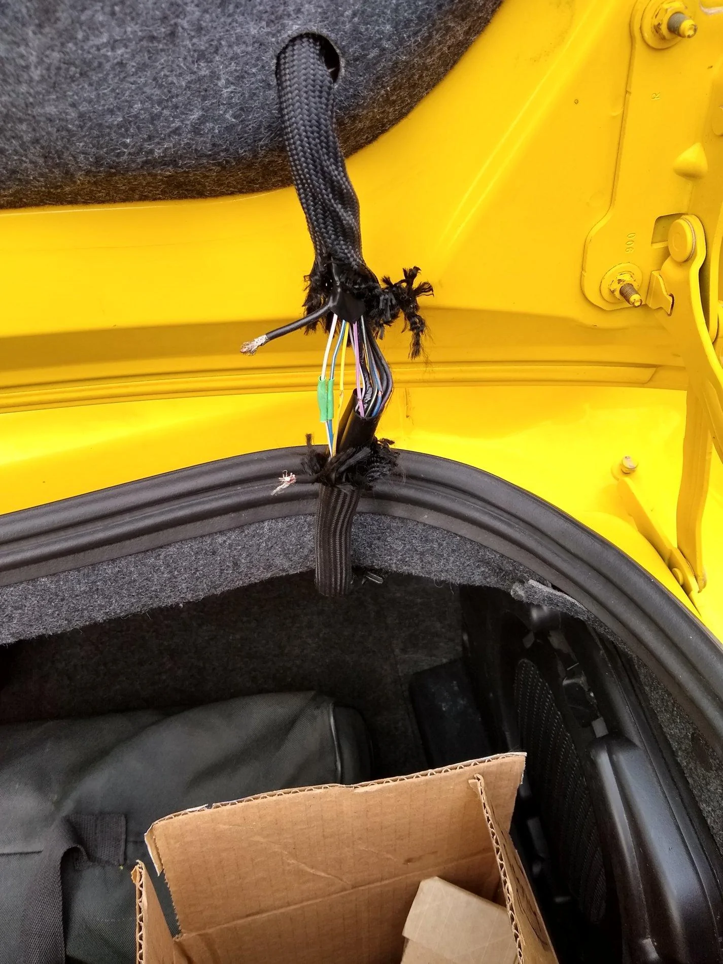

After getting your question, and looking at the reply from Bikeman315, I looked more closely at the wires and I'm going to attach pictures of what I found. Once I got the wires repaired everything works again.
Two wires on the left with green shrink tube have already been repaired and were fully broken.
