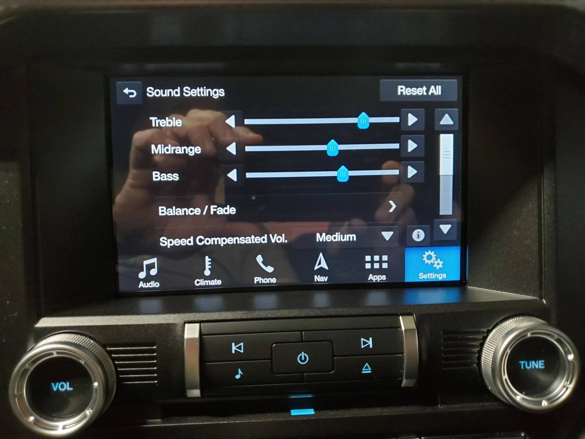

Most people say turning surround on is a big improvement. Give that a try.
I switched surround on and off a bunch and agreed, so I left it on
I'm old, so YMMV, but here's my settings:

Those are damn near identical to mine. I don't use the speed compensated volume though.
