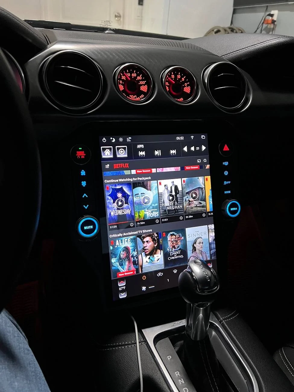

I scrapped the stock unit and installed this navi
And just replaced the sub speaker in the stock enclosure
Big improvement
Nice! Who makes? Thx
