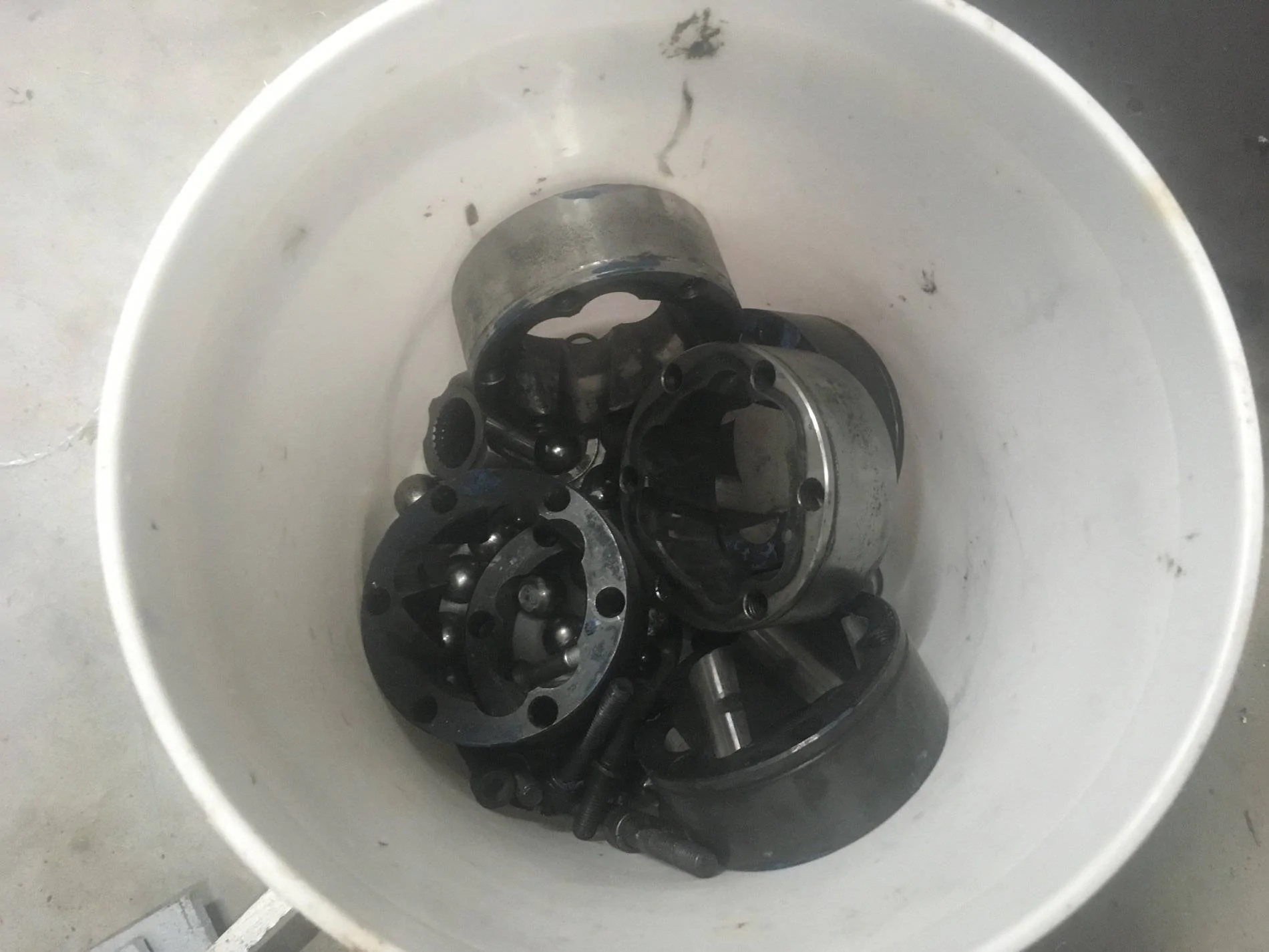

This is my collection of broken DSS 800hp CV’s, forcing me to become an expert at installing Porsche 930 CV’s.
As you’ve already noted, the 1400’s were rocking some dramas there for a while also.
I’d just skip DSS entirely and hope that the opposition are more competent. I don’t see how they could be any worse to be honest.
Damn. That's ridiculous. I appreciate the input!
