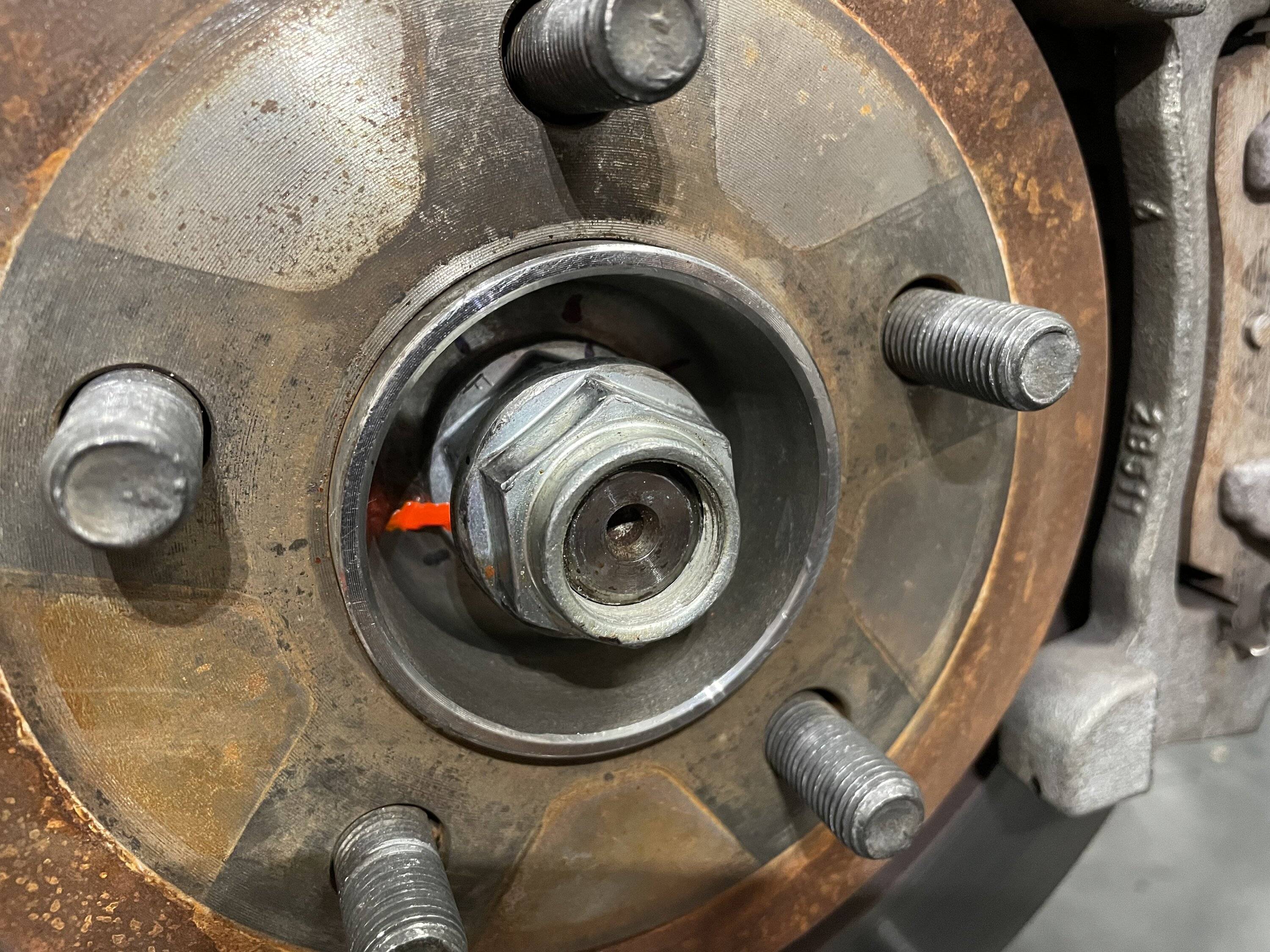

Idk in 10k ish miles the ref marks are still aligned. Most seemed to have gone to 150 + an 1/8th
Ford tech told me the same when mine were noisy, crank em to 150 and see if it stops, they didn't.
What? The ref marks haven't moved but the half-shaft joints are noisy? I'm not getting it... Are they just not tight enough or are they defective?
The ref marks I painted on. When I bought my car used and replaced all the wheelbearings.
Mine haven't "clicked" since I replaced them. I've had zero issues but I go through and double check stuff. I've modded most of my suspension, so I go around with a tq wrench before a trip or w/e and check.
If you look at keltech yt he's dragging and has had his axle nuts back off, and any of the wheel bearing how to's, the axle nuts had backed off.

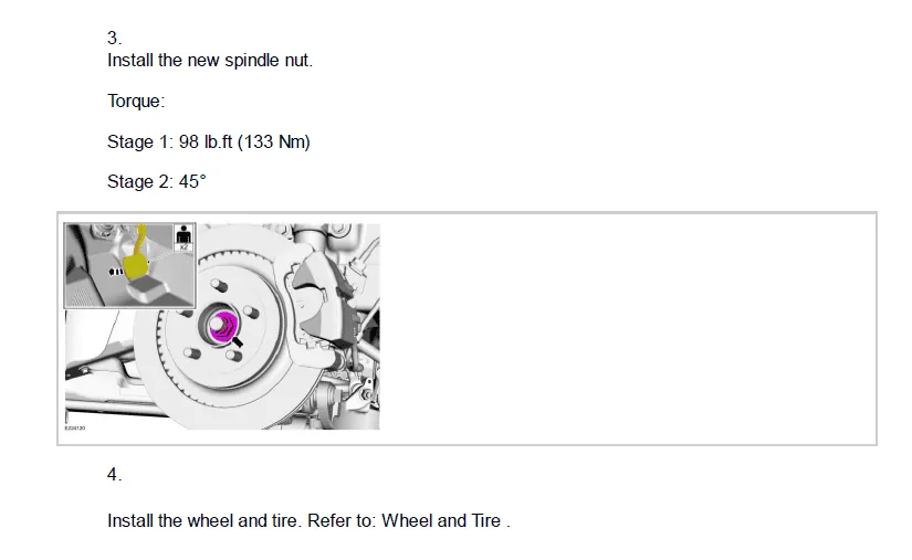

200 lbs?? Uuuhhh, where’d you get that number? These aren’t GForce shafts that call for 200. It’s 98 + 45°. I’ve heard 150 + 1/8 from a few, but 200 +??
That's what the service manual says

+ 45° my f$&@ing ass!!
No. Damn. Way.
I went 98 lb Ft and then with a 32” breaker bar, AND a pipe extension on the end of the breaker bar, I got somewhere around 20°…and that’s all I could get.
There’s red locktite on the nut, so I doubt that’s coming off. But no damn way.
