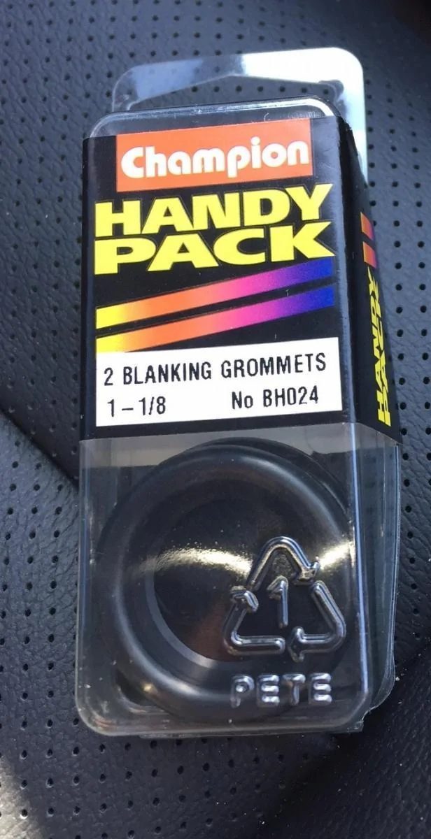

It might allow a little extra air in but the effect will be negligible. Really you just can't leave the hole open to suck unfiltered air into the engine. Obvious choice is to blank it off but adding a little filter like this will also achieve the same result ie stop it from ingesting dirt.
Actually, apart from sucking unfiltered air, there is a more serious issue....Unmetered air. An air leak after the MAF can potentiallty lean out the engine. Luckily there's less chance on these due to wide band EGO's however Load calculations are also effected.

Yes, didn't realise the MAF was before where the sound tube connects. Don't have my car yet. Solid cap is the better option IMO.

Yes the MAF is right after the airbox. They won't put other tubes before it because it will create turbulence that can stuff up the readings.

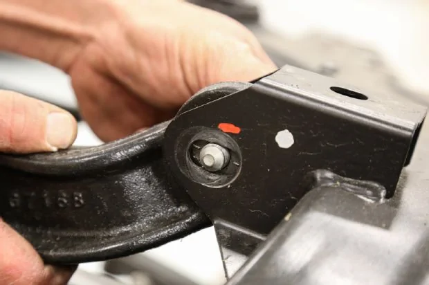

Rear Suspension Camber Adjustment
I know it is not Exhaust related but thought it may help some of you who have lowered or are lowering your Mustangs.
Having had a number of questions relating to rear camber adjustment after lowering here is a pic of where the camber adjust is.
It is somewhat hidden and sooo many suspension shops are not even aware it exists.
