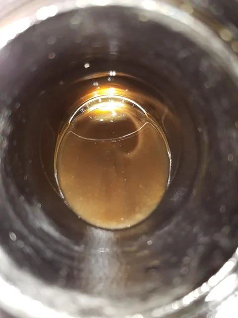

So here is the promised update, I have done around 3,500km now and the oil bypass is definitely slowing which is a great sign

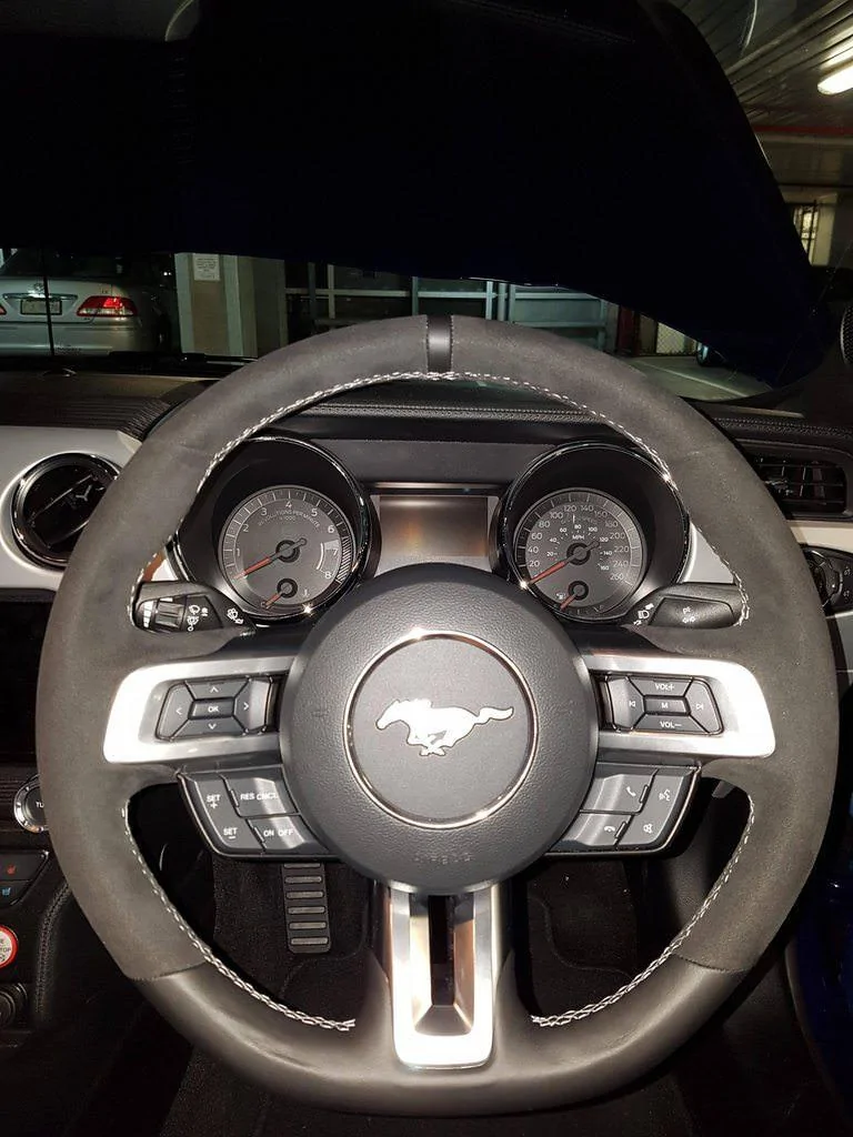

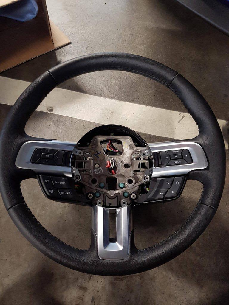

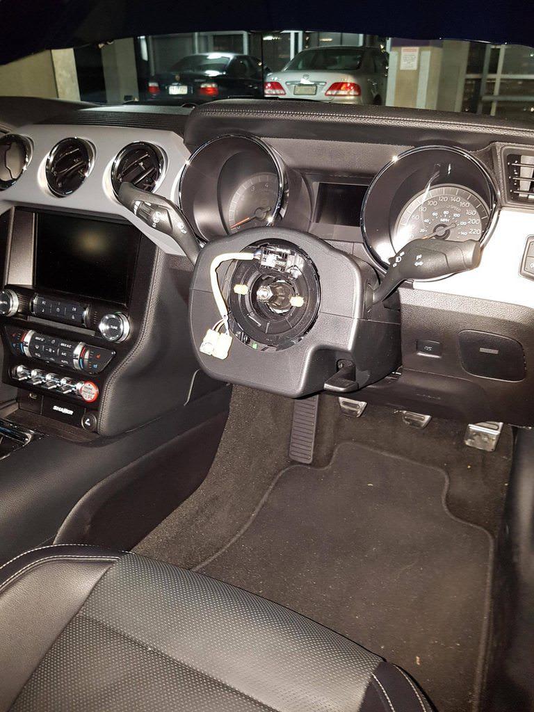

Last night I finally set some time aside to do one of my most anticipated mods, the GT350 steering wheel.
It took me about 1 hour 20 minutes, but I like to make sure everything is perfect and I didn't want to rush and end up pinching the suede.
My thoughts: The steering wheel is the most important part about the car and this mod is a massive improvement over stock, I love how it looks and feels.
Tools Required 3/8" drive Torque wrench 47.4nm required, 15/16mm 3/8" drive socket, socket extension tool, T20 screwdriver, 3mm hex key & small flat head screwdriver
Battery removal: 1/2" drive wrench, 10mm socket
Tips and tricks: the right had side airbag was easy to pop out but the left hand side was a little harder and I couldn't use my hex key so I used a small flat head screwdriver instead.
Finished product
