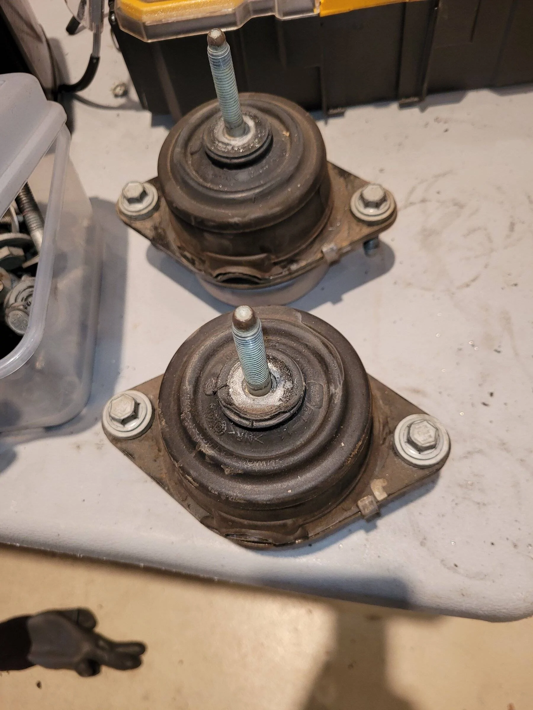

Are the stock GT350 VooDoo motor mounts different than what Ford builds the Coyote with? They must be due to the inherent vibration, but I don't know for sure. In the attached picture, I've removed the blue cover from the top of each mount. These are off my 2018 GT350.
What about the vibration dampeners on the exhaust system; are they different too. Is there a list of other differences? Thank you, still learning.....

The OEM Part Numbers are different:
GT350 uses same mount both sides
BR3Z-6038 @ $215+ per mount
GT & GT Premium use different mounts left & right
FR3Z-6038 @ $80+ per mount / side
