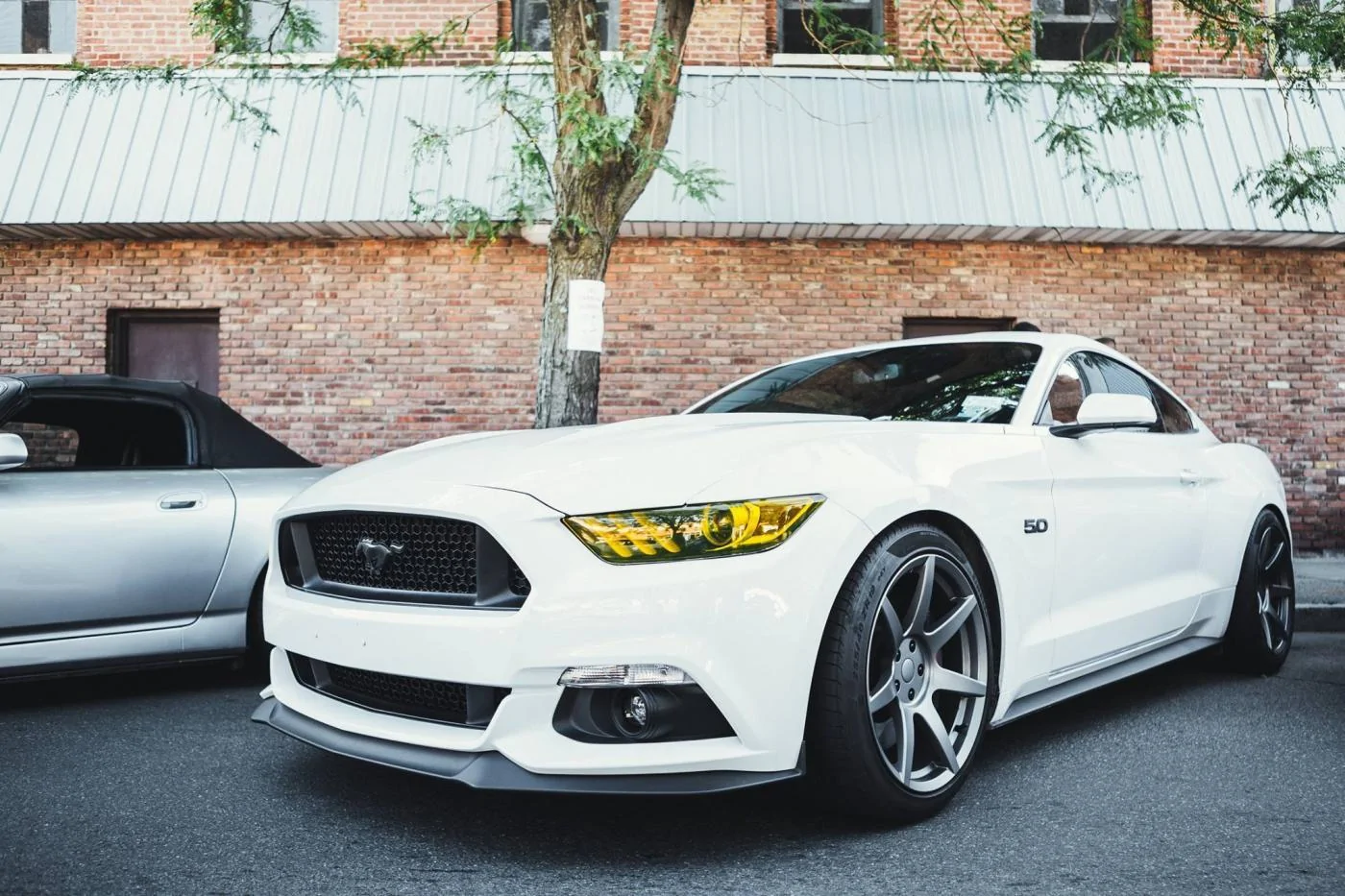

Is anyone running a square 19x10" stance? Trying to find something for the track but it's difficult to find the correct off set.

Yup. There are plenty of people doing this. A search will yield a lot of results.
I have 19x10 +35 Project6GR's. I'm running 285/35's in the rear, and will be running the same size up front very soon.

Same here. 19x10" Project6gr wheels +35 offset with 285/35R19 MPSS.

There are a lot of square setups
MRR M350
Stance Sf03
Niche Misano
Project 6GR
MRR other wheels
Vossen
Rohana
It all depends on the style and or a brand your after.
