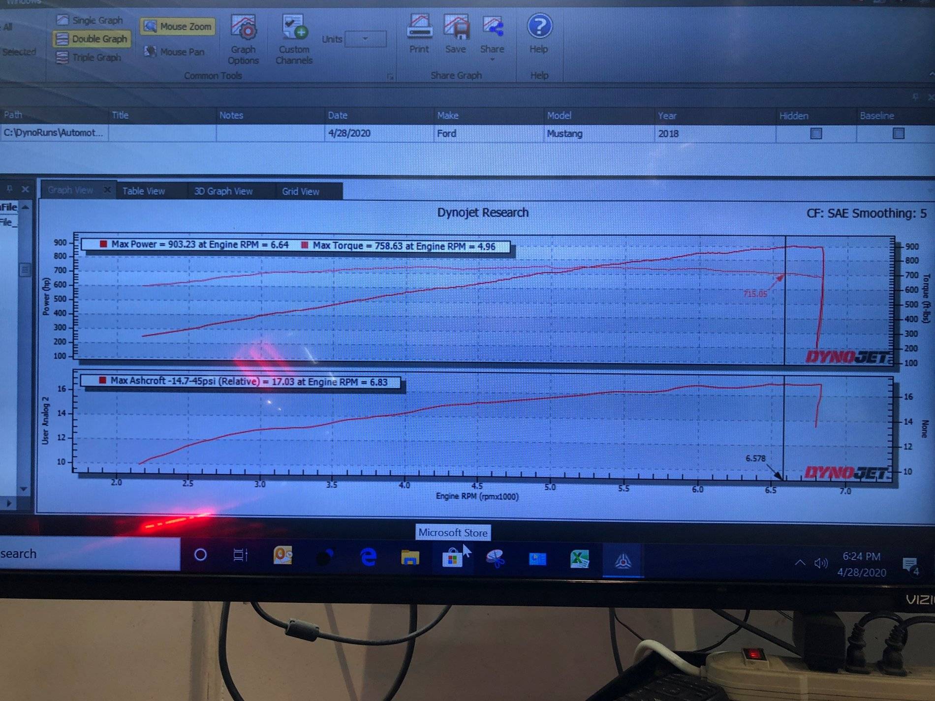

2018 Whipple Stage 2,401A, mag ride car here. Car made 715 on 91 PBD tune with a 3.75 pulley. Cars got pretty much everything done to it.

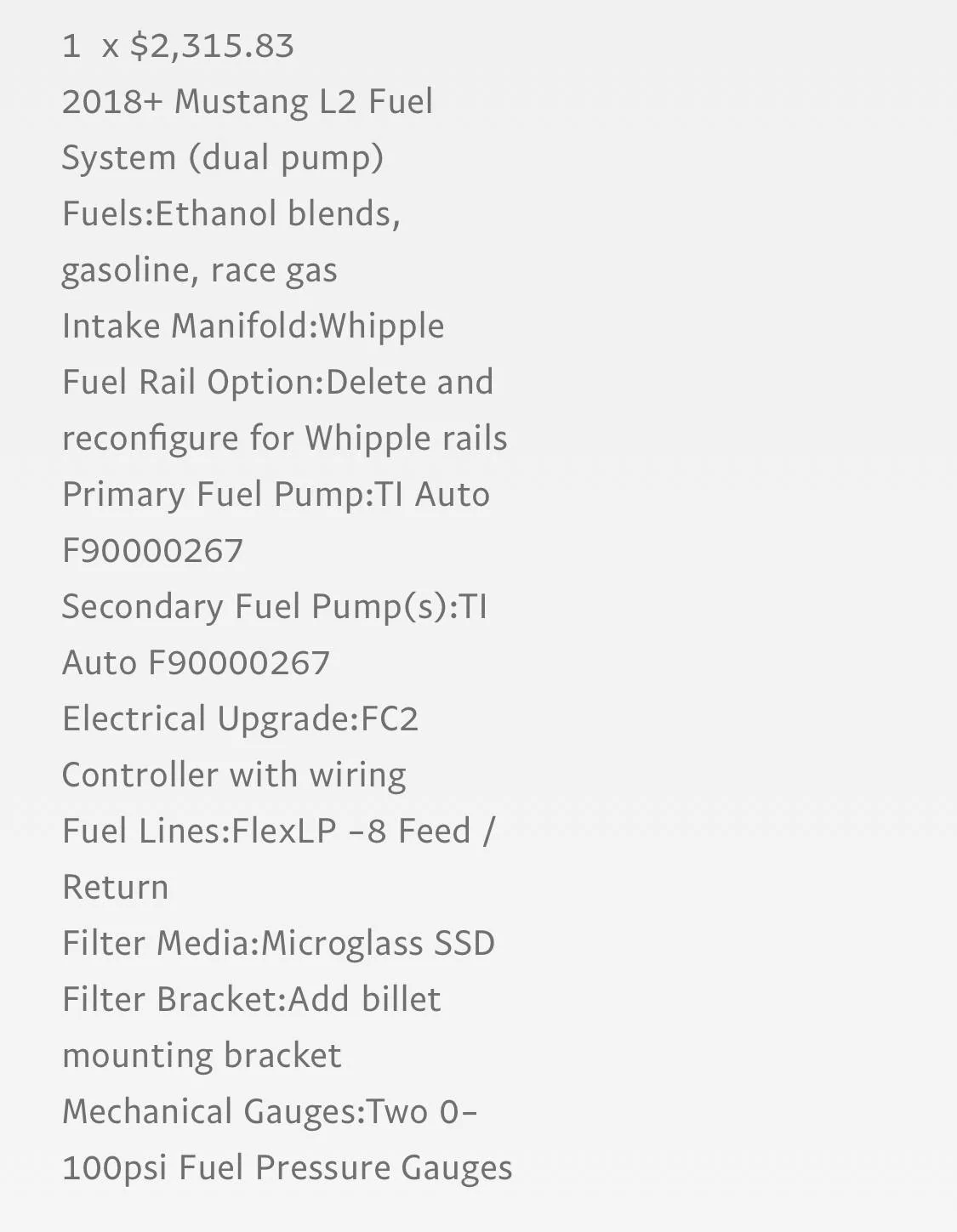

Currently halfway through installing:
Boundary OPG/CS
Fore innovations dual return system
Whipple 10 rib kit
ID1050X injectors
Kinetic crank stud,
Before I commit and get started on the return system part I just wanted to pick some peoples brains who run these and see if theirs any downsides or regrets. I obviously know the upsides of the system (more power/safer etc)Cars already fast and enjoyable. I can jump in it and go anywhere and put in on a lot of cars on the road in a race and not have to worry about it fuel probs. I hear stories of not letting the car run less than half tank etc/fuel pump heating etc but always take it with a grain a salt bc a lot of people talk out of their ass on stuff they hear and don’t experience first hand. My car is not a full on drag race car, I don’t track it but I like hitting some corners and spirited driving From time to time. it’s a second vehicle so I drive it every once in awhile but I’d like to be able to take it on a road trip if I wanted to and enjoy driving the car. I mean who doesn’t want 900whp car and it’s already got everything to support it, just want to make sure I’m not gonna look back later and wish I left alone That part of it if ease of drivability is dimished. I plan on not running a HOB switch and just wiring both pumps on. Car will be tuned for E85 and 91 Thx for any input!
