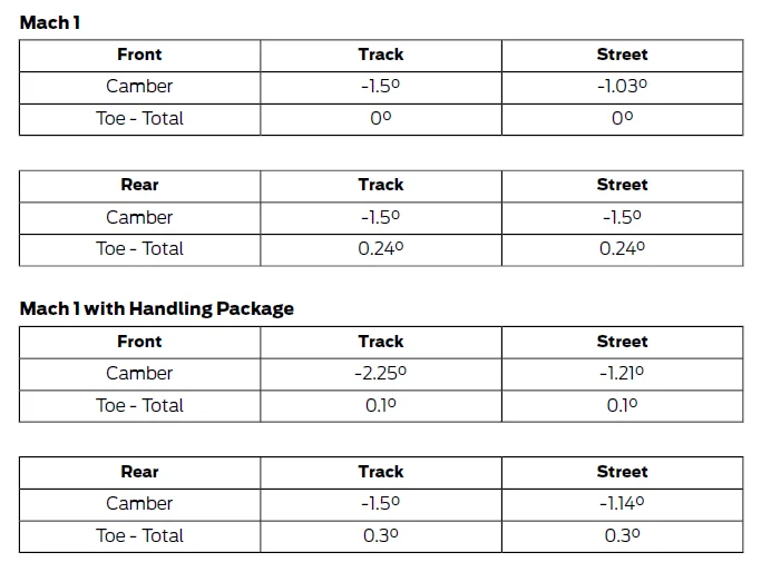

Good point about the brakes, they already have two track days on them, and a canyon drive. I would change them before hitting laguna. I have never checked my alignment from the factory, so I don't know what it actually is, but for this course I would get a shop to set it for track alignment according to the specs in the Mach 1 Owners Supplemental.

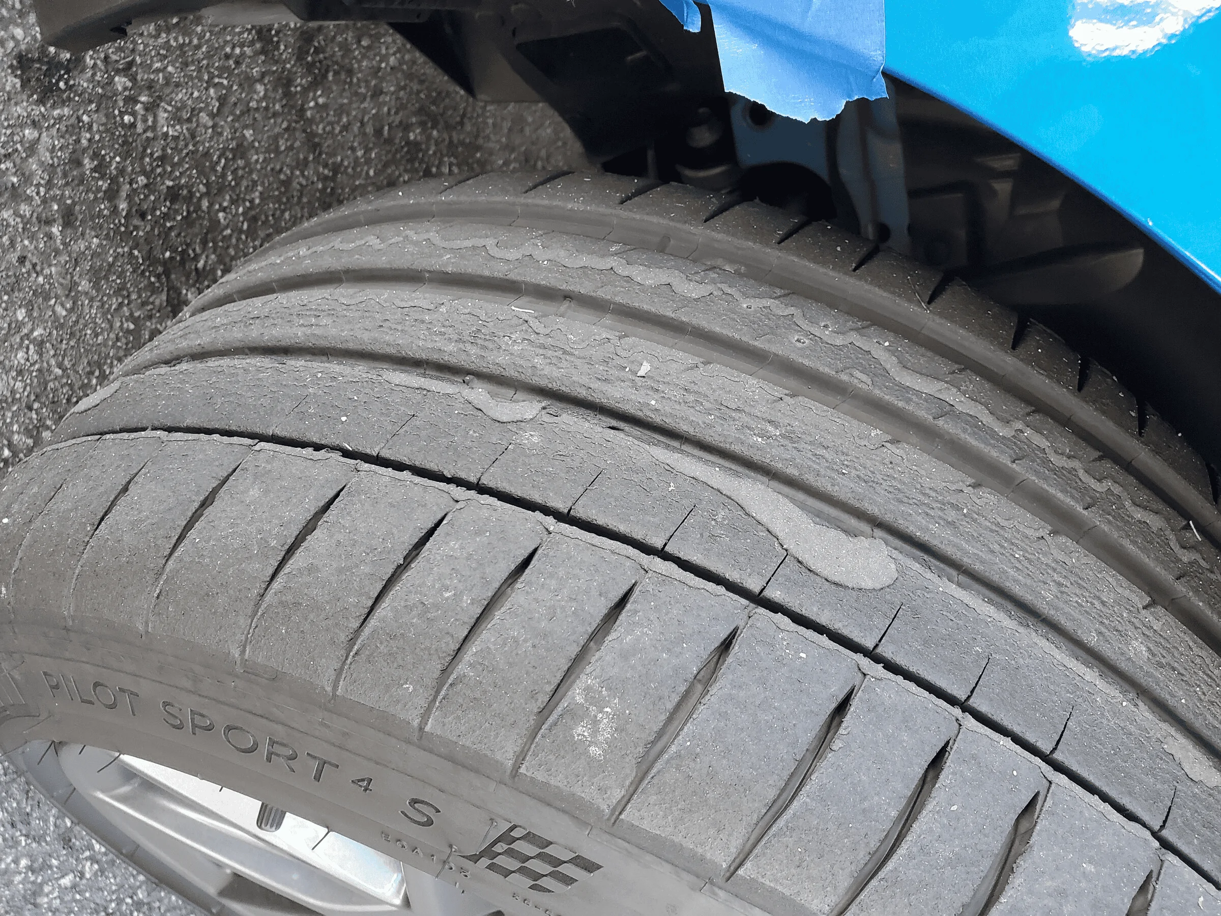

I remember from my Big Willow track report thread, that another member pointed out that more negative camber would be beneficial for me. Here were my tires after Big Willow
For reference I was running 1:40 at Big Willow, and I was leaving some time on the table there.

Front camber is not adjustable without camber plates and I don’t believe that the non hp came with them
And yes, more camber is always better
Which tire sizes you have fr and rear ?

Stock 255/40R19 FRONT 275/40R19 REAR PS4S
