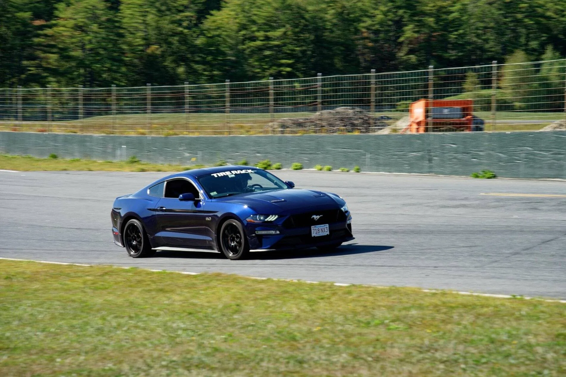

Just trying to do some research before I think seriously about new wheels/tires for next year. I know there are tons of 19" options, but I was hoping to keep the extra sidewall height for an extra bit of compliance and rim protection if possible. There may not be anything decent out there, but if anybody is running 265's or 275s on an 18x9 or 18x9.5 wheel without spacers, it would be great if you could post the manufacturer and model. Pictures optional, but would be appreciated.

18x9 front, 18x9.5 rear. Enkei PF01.
front needs 5mm spacers to clear PP1 brakes.

Thanks! PP1 brakes are not a factor for me, so that might simplify. Do you remember the offsets? Looking at the Enkei website both 9 and 9.5 wheels come in 35mm and 45mm versions, although they list it as "inset".
