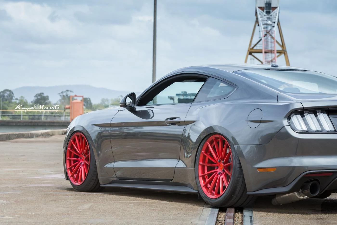

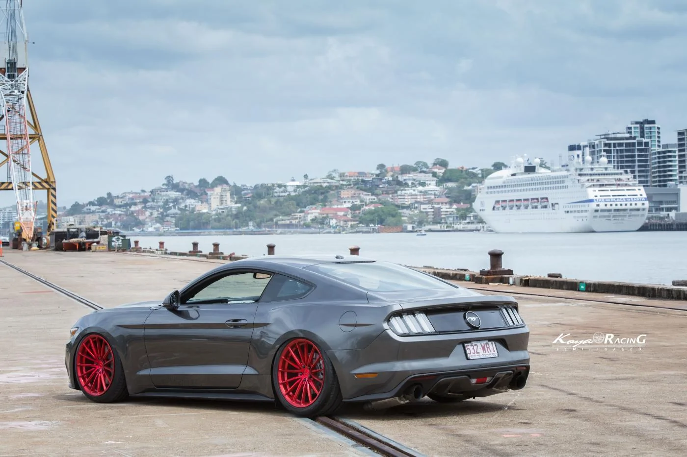

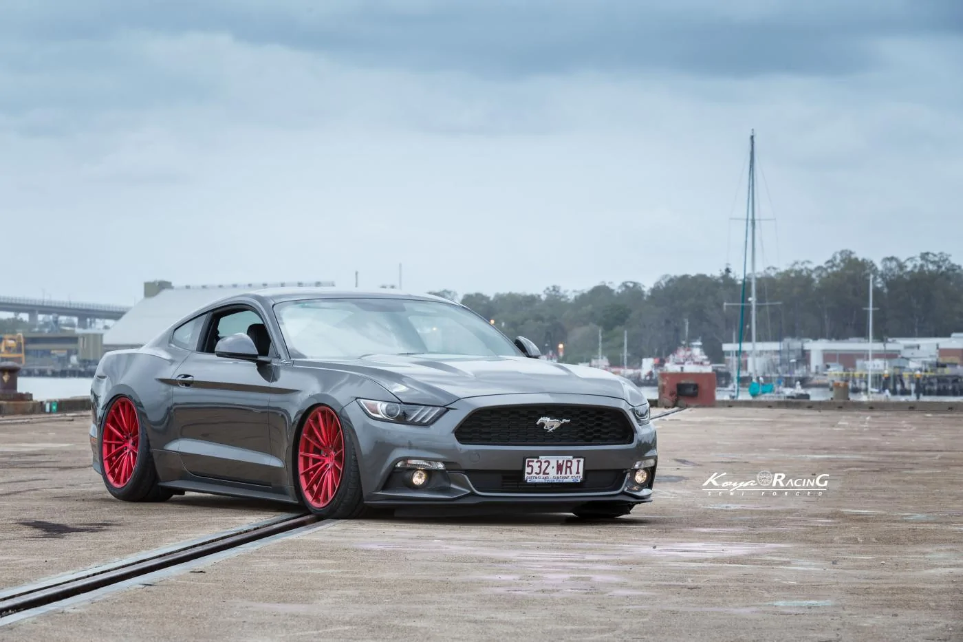

Haha thanks @Burkey , yeah 6mm further out was my calc. So you think that's too aggressive? That'd make it like 3 degrees of camber yeah? Erkan is running that setup (different design, same specs) with a stretched 275 and camber within spec (on sportlines), probably need to see it in person to decide.
I wish they made the wheel in a +45, I'm in love with the design
