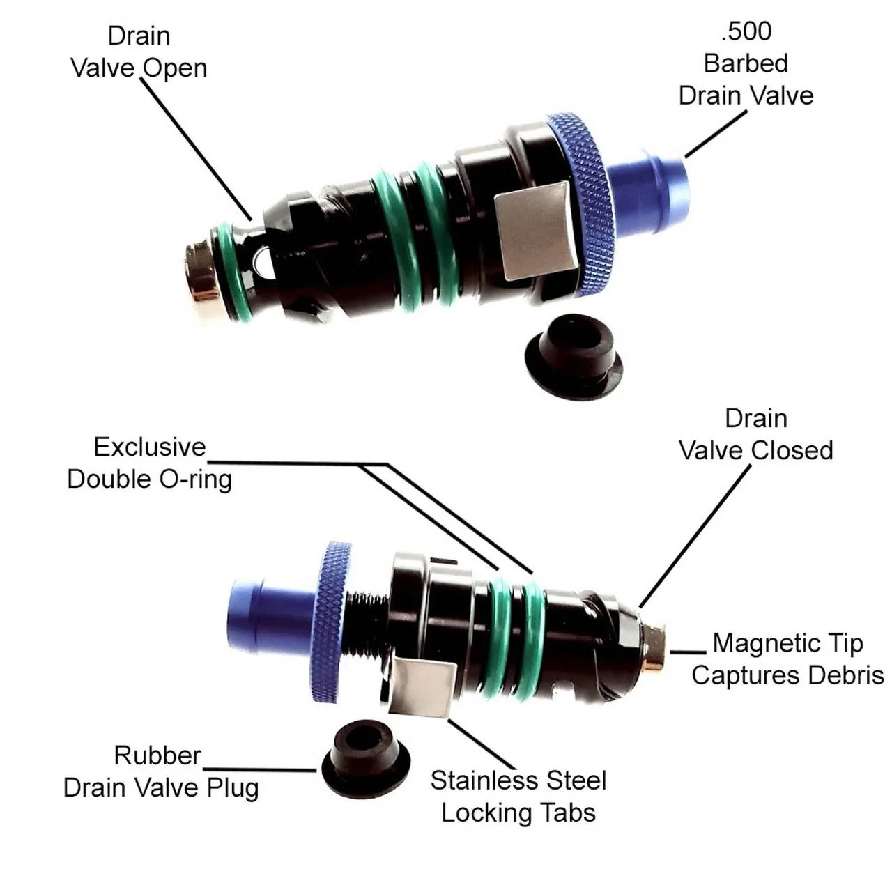

I was wondering if anyone has the new drain valve UPR has made and what do you think of it?
My initial impressions are
1. I like that it is all one piece. no parts to lose (except the rubber plug)
2. If one o-ring was good on the stock plug and on UPR billet plugs, why does it now require 2? Might be to add some friction to help open the valve without removing the plug part.
3. To OPEN the valve, you need to turn it clockwise. Why? I could see some mechanic turning it counter and end up removing the entire thing. Not a big problem because then it would still work like a regular drain plug. I believe they did this because that would tighten the locking tab against the stops but you still need to turn it counter clockwise which would loosen the plug? not sure on this. Not sure it matters either way. As long as they unscrew it all the way before they start adding oil. Forget to do that and yu have oil all over the place. I think they should have etched <- Turn to Close Valve" and "Turn to Open Valve ->" on the blue valve handle face. Make it impossible , ok or less likely, to make a mistake.
4. The blue valve handle stays attached. Good!!! no parts to lose like the Ronin which I am not sure you can buy spares.
5. The blue valve remains with what I would guess is 3/8" to 1/2" sticking out. Not sure I like this. Debris can get in there and gum up the threads requiring cleaning prior to draining. Not s deal breaker. Keep an old toothbrush in your oil change kit solves this. I was thinking of getting an accordion boot or rubber hose to fit over the blue valve handle to cover to keep this area clean. What bothers me a little is if something was to bounce under the car and hit it, how easy is it to get bent?
6. Rubber drain valve plug - there goes the idea of no loose parts and not losing anything. I am not sure how necessary this piece is and after speaking with UPR on it, it really doesn't seem to be required. Only trying to help keep things a bit better. I would have rather them put a cap with an attached o-ring so that the cap remains attached. Maybe if they could not find a o-ring attached one, we could simply poke a hole in the rubber plug, run a string through it and keep it attached with a knot and tie it to an o-ring that slips over and past the barb. A little length can allow it to hang there. Could even use a piece of light bulb pull chain if you wanted. Make it just long enough for the plug to be removed. The other thing that a plug makes me think of is the fact that maybe the valve can leak so they put a plug to prevent it from dripping. They should sell the rubber drain valve plug separately.
7. How do you take it off to get at the magnet? I guess the reason for left o close was so that you could close down the valve, taking the stress of the threads and be able to remove the valve to get at the magnet for cleaning/inspection. So the 'Turn right' to open the valve might not be so bad after all. Wonder if with two o-rings how easy it is to remove it now.
8. How easy is it to open and close the valve? Is it easy to remove the entire assembly? Which is easier: removing the assembly or opening the valve. I hope the valve does not require you to hold the base to open the valve.
Would have loved to see the valve knob offered in different colors. Either that, or just make it black or gunmetal or just make it look like their billet plug.
In all, I think it is a nice part and I like the idea.
What are your thoughts?
If you liked the idea of a drain valve on your Mustang which do you like the UPR or Ronin drain valves better? Why?
Would you purchase this part or the regular UPR plug and just deal with the possibility of a mess?
Thank you for your feedback
