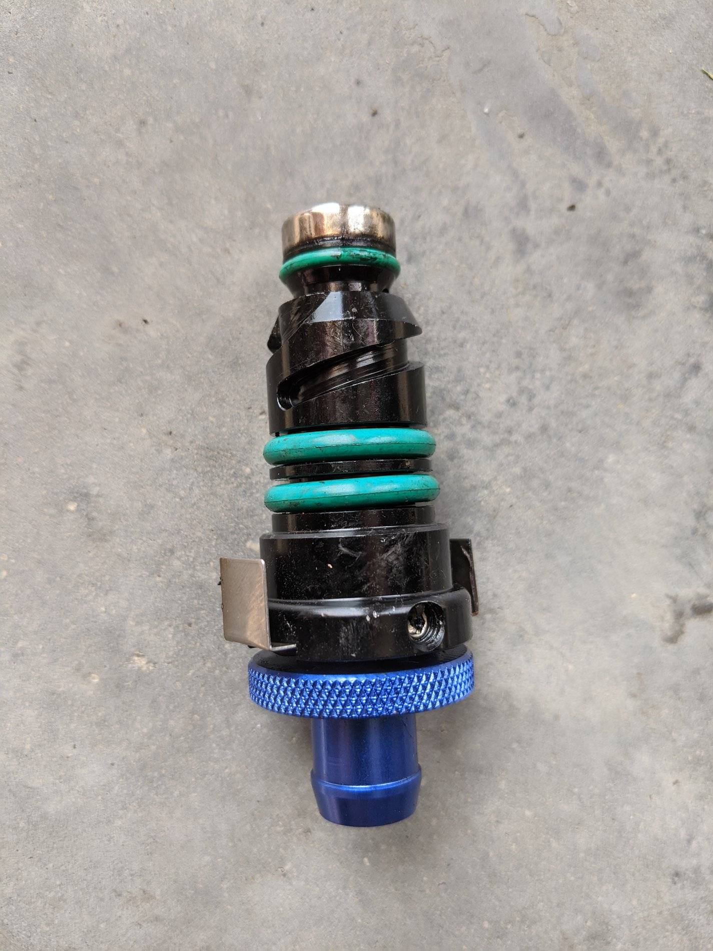

A pinch of salt to this thread - at SCCA Bristol Championship Tour that I participated in last weekend, drain valve in UPRs plug backed itself off at least one full turn after running over a cone. I pulled into impound and was told I'm leaking oil - which I was.... Shut the engine down immediately, after about 10 minutes entire oil was gone.
While this is extremely rare occurrence and it's unlikely to happen anyone daily driving their car, it can happen - I was in the lucky situation of participating in the event and having multiple eyes on me. Had this happen somewhere on the road, entirely oil would have been gone. Wet spots around the car is some of 10 quarts of oil that my car dumped all over the place.
Not trying to shit on UPR's product but people using it have to be aware of this possibility. Replaced with yellow Ford plastic plug I've had with me as a back up and not putting UPR's one back in. Also disclaimer - car is slightly lowered.

Joe - appreciate the response and its tone - tabs were fine, it was the knurled valve know that got turned open - I think the plug as removed is fine and there is nothing wrong with it.
If you look at the picture, that is more or less how it looked seating in the oil pan - I don't have a picture unfortunately, but it was the heat of the moment, car pouring oil everywhere and taking a pic was last thing on my mind. Valve was clearly backed away about the distance pic shows it.
The fact that it was only the knob and not the tabs / entirely plug actually resulted in a relatively slow oil loss, had the entire plug come out (which could be the case with the plastic OEM one), oil loss is immediate and would likely result in the engine damage. Again, highly unlikely thing to happen to anyone

Joe,
after reading this I decided to check my yet to be installed drain plug and saw that it only takes about 3/4 to 1 full turn before the inner O - ring shows a visible thin gap allowing oil to flow. It might be less than this since I was only going by eye (and I wear glasses). Since it only has whatever oil/lubricant you ship with, at first it was firm to turn. Once I exercised it once or twice it loosened up. it became rather easy to turn. It was not stupid easy but required rather little torque to cause it to unscrew.
My thoughts are:
1. it needs a tighter fitting o - ring to put more initial friction to reduce the chance of turning. Of course this could cause the o-ring- wear prematurely. 0.1 - 0.2 mm thicker o-ring might do the trick.
2. a longer thread so that it will take more turns before the valve begins to drain. I would like to see two or three full turns before it begins to pass oil or leak/drip.
3. It should be machined tighter or a nylon insert or something added to create greater friction increasing the torque to open the valve. I suggest this b/c I wonder if the valve loosens up when it is installed and heated by the oil and a hot engine. If it does, it will be even easier to turn once hot.
I was thinking of slipping a rubber hose over the exposed assembly to keep dirt out but I wonder if that would also help reduce the tendency to turn. The friction of the stationary part would keep the valve knob from turning even if the hose was twisted.
just some thoughts...
Interested to hear if and how this might be changed.

Joe,
What is the purpose of the setscrew on the black part behind the valve? Does it adjust backlash?
Thank you for the response and let me know if there is any help you need from us or if your worried you damaged the drain valve.
The valve is designed to allow pressure between the seat once the aluminum touches and is fully closed.
The set screw is to allow you to adjust the pressure when turning the drain valve. You can adjust it a bit
tighter if you want to increase the detent against thee threads making it harder to turn. Never over-tighten
anything, as they are all designed to be light interference fits, and lasts the life of your vehicle.
Thank you, Joe
