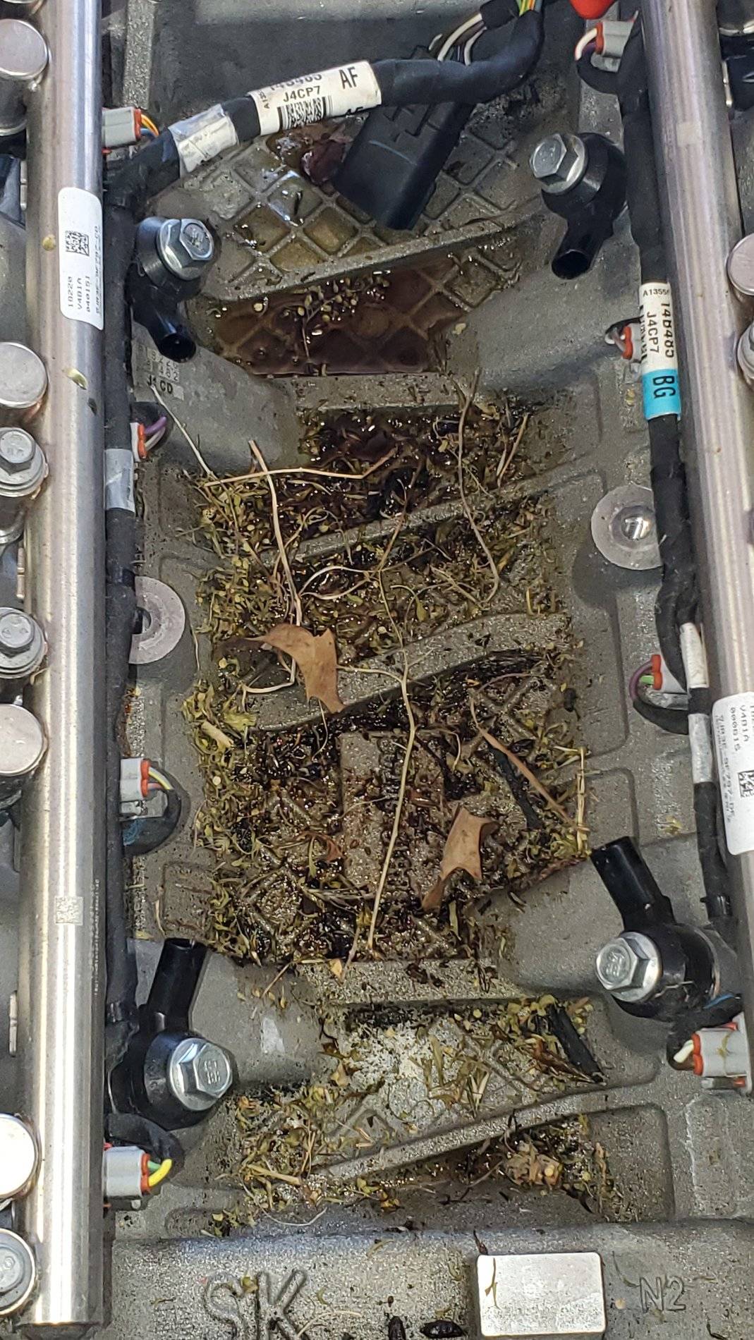

Ok guys here is what I've found out so far that code is obviously bank 1 knock sensor 1.....now when my engine first messed up the stage 1 trim had been on a while and it was clear "critters" had been in there.
I asked the Ford dealer to replace the subharnesses under there when they did the engine...( at my cost) well the new long block comes with the DI harness and new knock sensors but not the knock sensor break out harness. What I've discovered is you cant get it, back ordered with no availability. So they didnt replace it would seem as I called their parts department and looked it all up and its unobtainable.....

This photo is AFTER Ford removed most of the next from the first engine...their photo which I cant find had it PACKED....cant imagine knock sensors were working right with something so tune via ohms how could the PCM ever get accurate data if it's been getting mutilated....of coarse the car sits more than its driven for obvious reasons....I hope it just all stems back to this harness...I'll report even if I take it back to stock just so everyone knows for posterity.

Thanks if anyone thinks of anything else let me know and this photo is AFTER they vacuumed it out...bear in mind new car 3k miles at the time....

Holy cow!
And that pic is from AFTER the dealer “cleaned and vacuumed” it?? So am I to believe this is the way they left it when they put the blower on or did you actually clean it properly?
What’s all the fluid there?

The photo is what I took and this is after the bulk of it was cleaned out when they called me up there to look.....When I arrived they showed me a picture and this was literally 5% of what was packed in there when they took the blower off...now I dont know if the fluid was coolant from removing the blower ect....they just wanted to show me ( which is when I said replace all subharnesses everything inside of there and they said it all comes new on the long block but i now know the knock sensors do NOT come with new subharness the DI does, I also know they couldn't get that subharness so reused it and nothing was ever thought of again till it got the circuit open error yesterday).
This is the first engine so basically the core back to Ford the new engine was spotless before they put the blower on and honestly its spotless when it blew up as well I have photos of it ( 900 miles)....
I do think either the harness was compromised then with initial infestation, that led to corrosion over a year and now circuit is open, pinched or a new infestation......

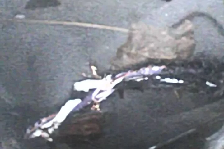

Weirdly after thinking I have seen the wire on the knock sensor and isolated the subharness plug messing with both.....
You can clear the code and it stays clear unless it acts up the knock sensors say 6 or 7 times. While you would think its polling them constantly...if you set there and rev it a bit fine idle for ever active no code...
If you load in and its algorithm in this case adds timing after a few times of that you get the code...I would think its reading open circuit or not to that sensor....I tested twice as long as you dont put the engine in a load that induces the tune to add timing it will not trip the P0325...problem is even with normal driving the tune often adds up to 10 degrees you would never stay out of it.
I'm fairly certain that wire is on the number 1 bank 1 knock sensor....

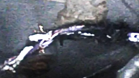

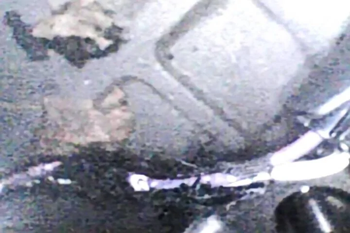

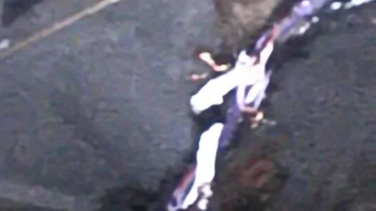

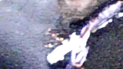

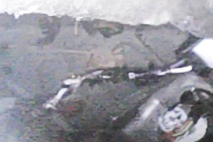

Just wanted to update everyone, after double checking everything out back I did get my POS bore scope up long enough to get these....Yes I know they arent the best photos but its clear something has been at the wiring I think thats either DI injector 1 or the Knock sensor 1 bank 1. It was just sitting there and hadnt been driven hard at all during this phase cross your fingers....I have a spare DI harness from my core and the new injector subharness on the way.....
As you said the EB is rolling its just literally the worst luck ever, the car does now have a 20x25 garage with 10ft roll up ( wife claimed 20x10 of the 20x35)....so maybe get the DI harness and Knock Harness replaced and might forgoe axles on a second gear leave the first time out roll the dice.....cause I cant pay for this and the axles right now ( was literally calling to order when I got back from pharmacy which is when it tossed a code, thank god I didnt )

That could definitely explain your bad luck. I hope you can keep those critters in check.
