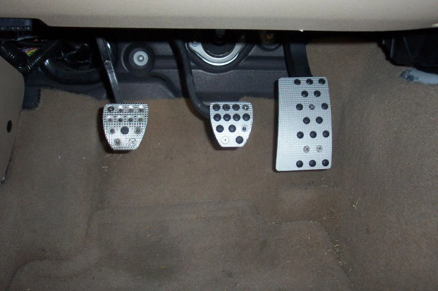

You might want to look at a gas pedal pad extension cover. Then when trying to blip while braking before you down shift its not as awkward to push or roll your foot over both pedals.
Photo attached is what I had on my 05 Mustang GT
Perfect set up to roll your right foot over to blip the throttle. Just be careful not to hit the throttle when you want only the brakes!
