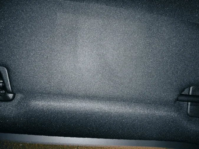

Anyone had success removing the Airbag decal on the 2015? This buy used a hair dryer to remove the decal, but suggests that a heat gun would also be helpful. [ame="[MEDIA=youtube]aLRomL7ifLo[/MEDIA]"]guy[/ame]
Would you suggest removing the visor or remove the sticker in place. If you removing the visor, any tips or tricks?
Endokendal
Dec 8, 2014
1,010
409
Albuquerque, NM
2018 Mustang GT Premium Ruby Red
