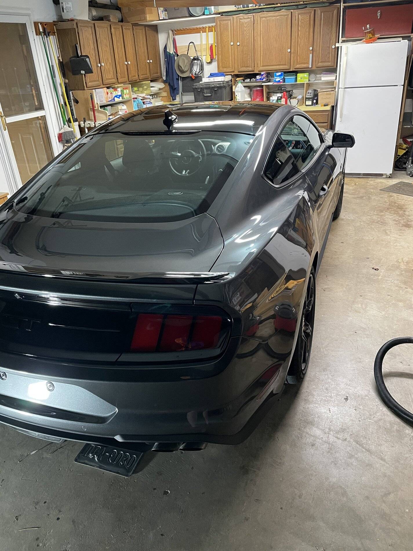

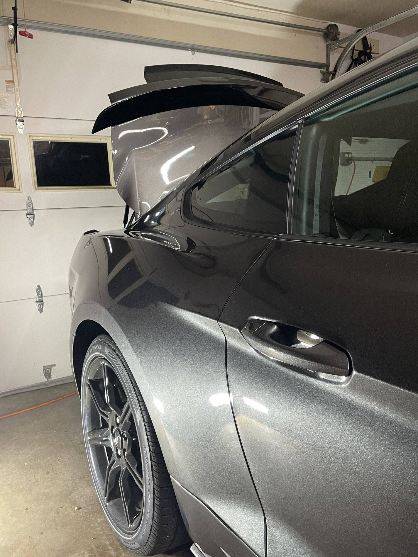

I did mine with CarPro UK 3.0 with a top coat of Gliss. The car only had around 1k miles when I did it, so there was no need for polishing and most of the prep that would normally be needed. Took a weekend with about 10 hours on Sat for the wash and prep then two coats of UK 3.0. Sunday was another 4-5 hours for the Gliss top coat. Turned out great!
After a couple months:

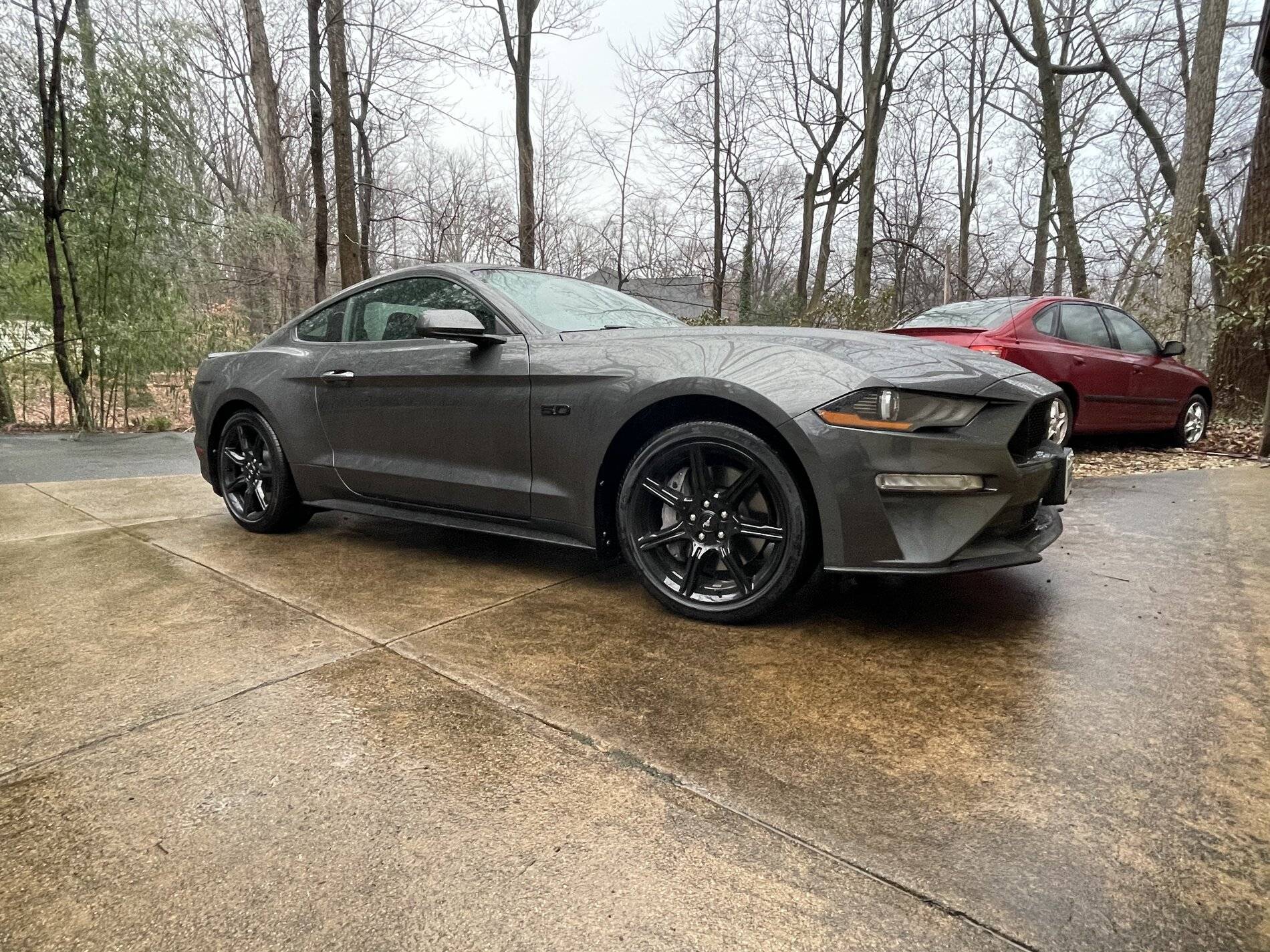

I've read many times that putting a wax or sealant top coat on ceramic is not a good thing. The surface is so slick already that waxes and sealants won't hold properly. Hazing and cloudiness can occur.
It's only been 3~ months since I applied the coating to the Mustang. So I have no long term info to give. That said, it's been holding up really well. The car has been snowed on and shit on. Both of those came off easily.
I should have noted that the last pic I posted was in the rain. It just starts to beed then gravity takes it away. It's very slick.
