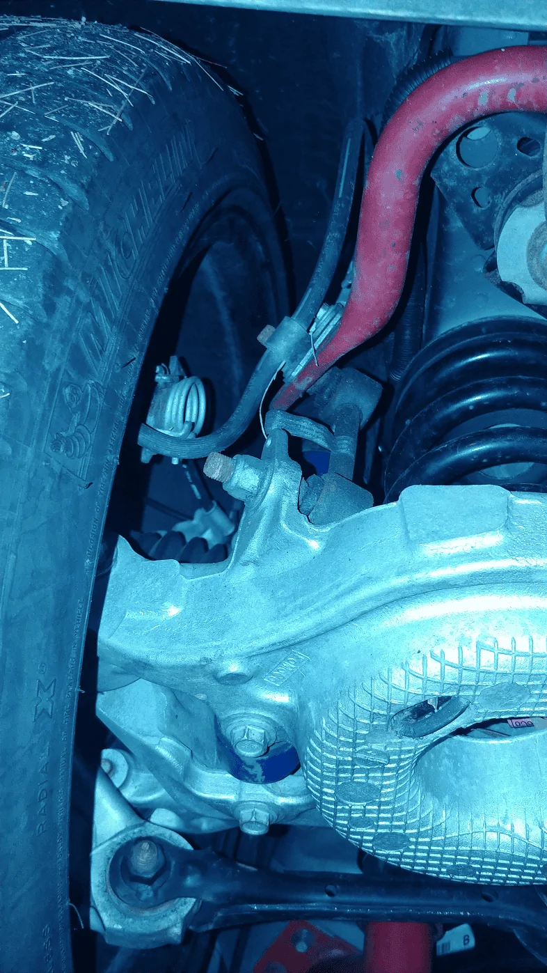

But the wheels im looking at have +55mm I wonder if there will be any rubbing with any suspension component.
You have plenty of room inwards even with +55. I have +50 and have about an inch of clearance to the inner fender.
