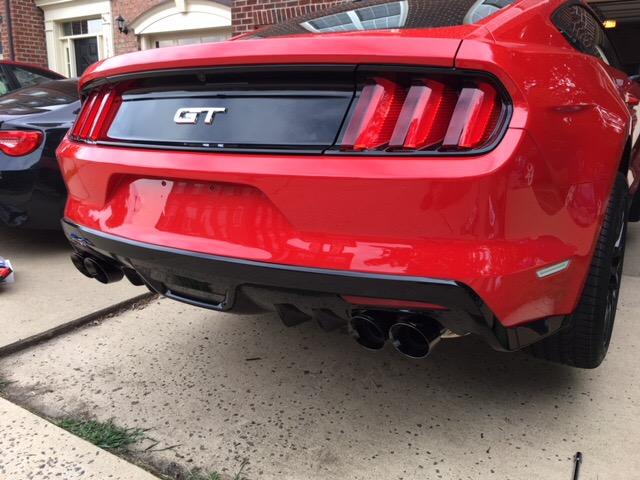

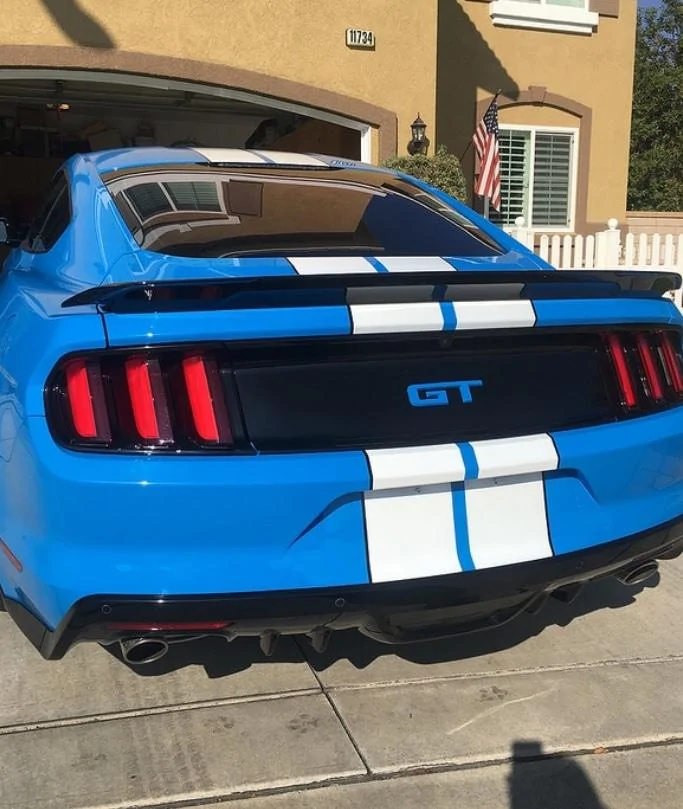

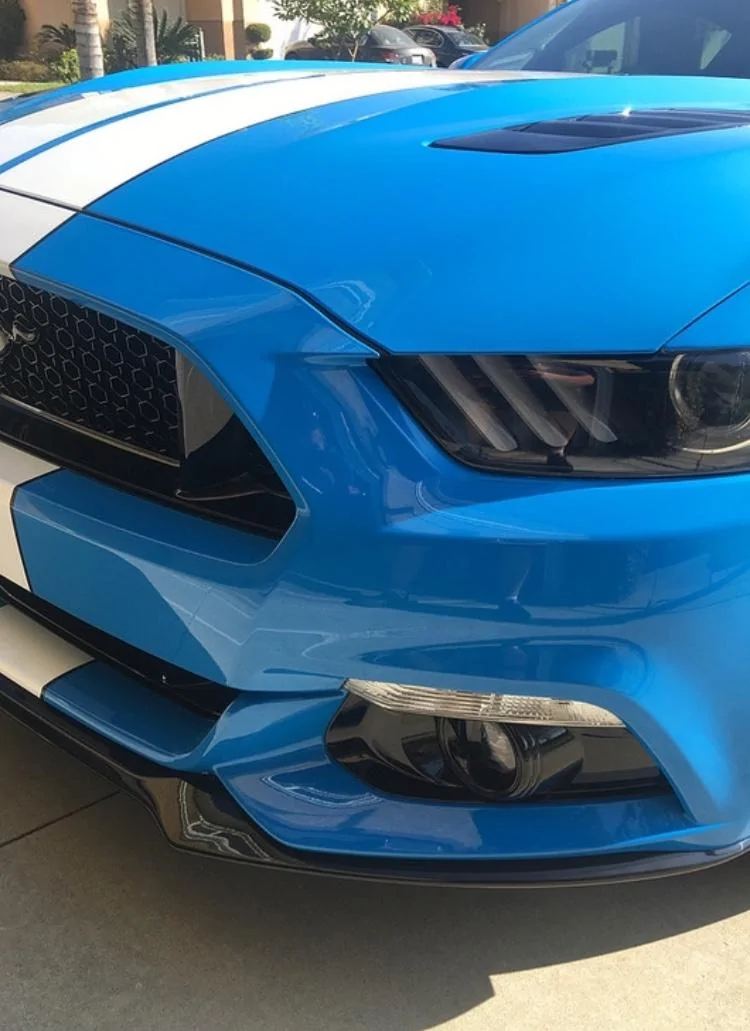

I’m prepping to pull the front spoiler, rocker mouldings and lower rear valence to paint them gloss black. I’m also painting the stock lower grill and RTR hood vents. Roof is getting wrapped w/ 3m gloss black.
I pretty much have the process down thanks to a good friend that’s a painter (lives too far away to do it for me) but wondered if anyone had anything to add. Adhesion promoter will def be used.
Getting a quote from a buddy’s brother that’s head painter at a good local shop. I’m guessing they’re gonna want a fortune though so I’ll prob end doing it myself.
These pics sold me...

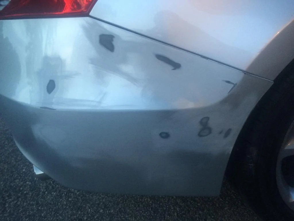

I did a bumper repair on my last daily driver. A buddy who paints for a living didn't believe me when he saw the results and I told him it was all spray can.

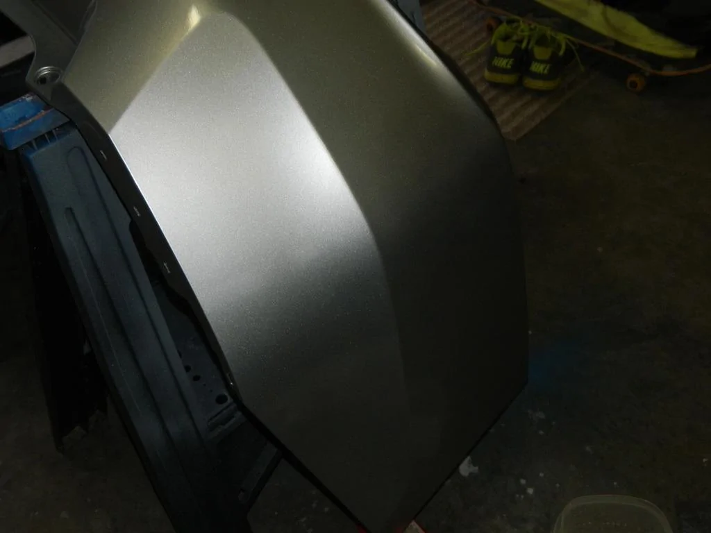

That's the bumper I repaired after sanding and then some scuffs of filler.
Here's after adhesion promoter, primer in bare plastic spots, base coat and clear. Ignore the potato camera pics...
