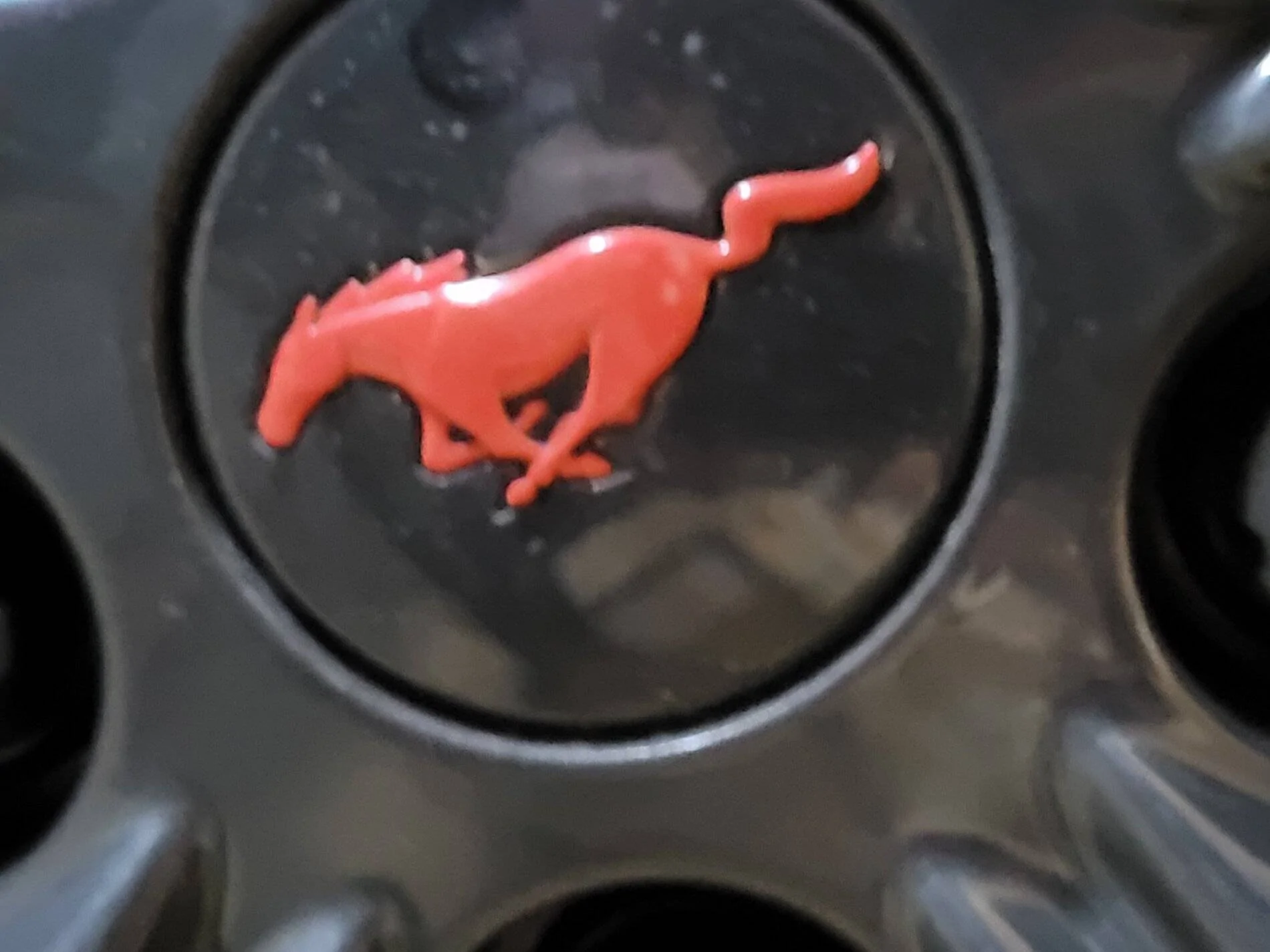

Any local body shop or, better yet, a custom paint shop can do it.
Honestly though it's a pretty easy DIY job if you've ever done any paint work. With care it will come out and be very professional looking.
I painted the chrome ponies on my factory center caps to match my Race Red convertible. They came out perfectly.
I ordered the paint and clear coat in rattle cans and used a good etching primer.
I don't remember off hand where I got the paint from but the paint is specially mixed using the paint code on the door. It can be ordered in touch up pens, rattle cans and pints and quarts
