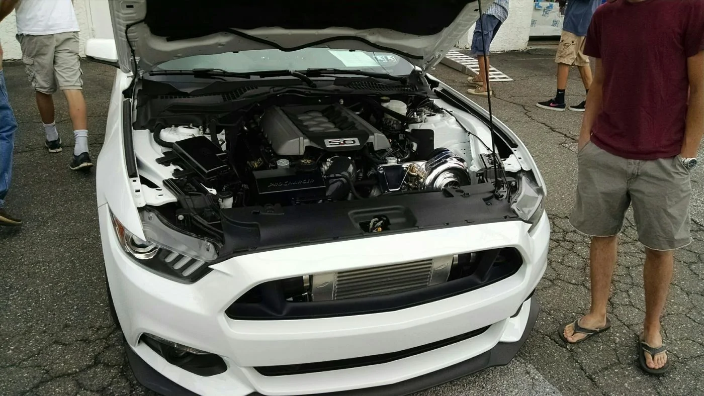

I saw this procharged 15 running nitrous at the evolution performance show but I'm not sure if the dude is on the forum
