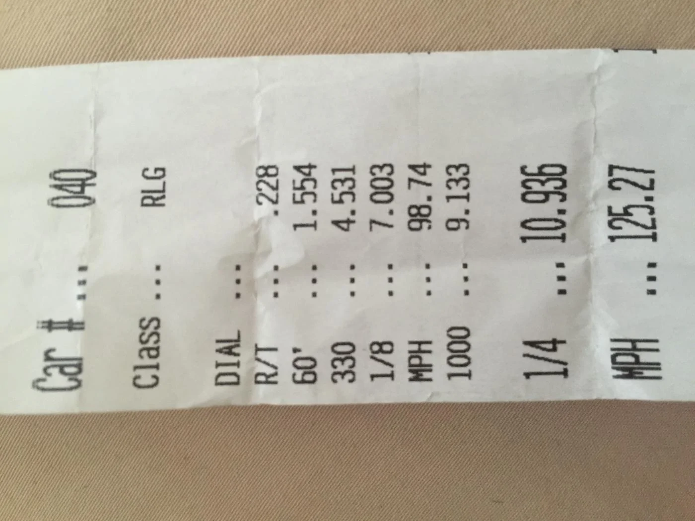

I think I'm going to try it manually to find a ball park and then use the controller to bring it in based on time.
I gotta say, the Maximizer 4 controller is pretty sweet.

Got mine figured out. I can set the delay based on RPM or TPS. I am testing having the delay start with WOT and come on 3/10ths after I drop the hammer with a progressive hit over the 60ft. I will lock out and stay armed even if I lift a tiny bit to shift.
I may try to build a program using the first gear lock out feature and have it come on a few 1/10ths into second gear. We shall see! This controller is nuts, lol.
