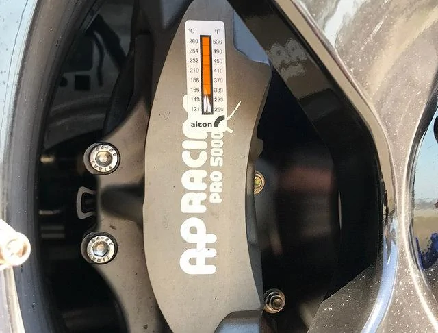

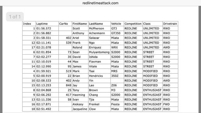

Did my first time attack event a few weeks ago and did very well. I placed second overall behind a GT3 Cup Car with a Grand Am kit.
Current wheel and tire setup are the 5 spoke P6GR wheels in 19x11+50 all around with a 30mm HR bolt on spacer up front. With 315 Pirelli Slicks on all four corners.
Please excuse the spelling, I didn't make the trophy :rant:
The AP brake kit is doing phenomenally well, on this 100F+ day no fade or hiccups in the brakes. I put Alcon stickers to get an idea of the Caliper temps and they didn't pass the 300 mark.
