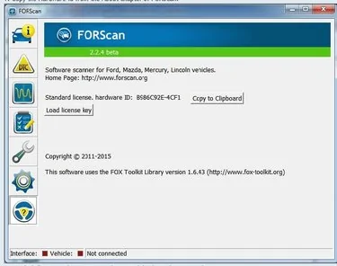

Not wanting to read all 120 pages of the forscan stickie ,I have a ?
I have downloaded forscan and have the cable but to get the license forscan wants to know what the hardware id # is
? is where or what is the # ,is it the computer,cable, or vehicle?
Thanks in advance

go into help about i think in the forscan menu it shows a hardware ID, basicly locks forscan to only work on that machine. Forscan installation guide has it also

Click on steering wheel icon
