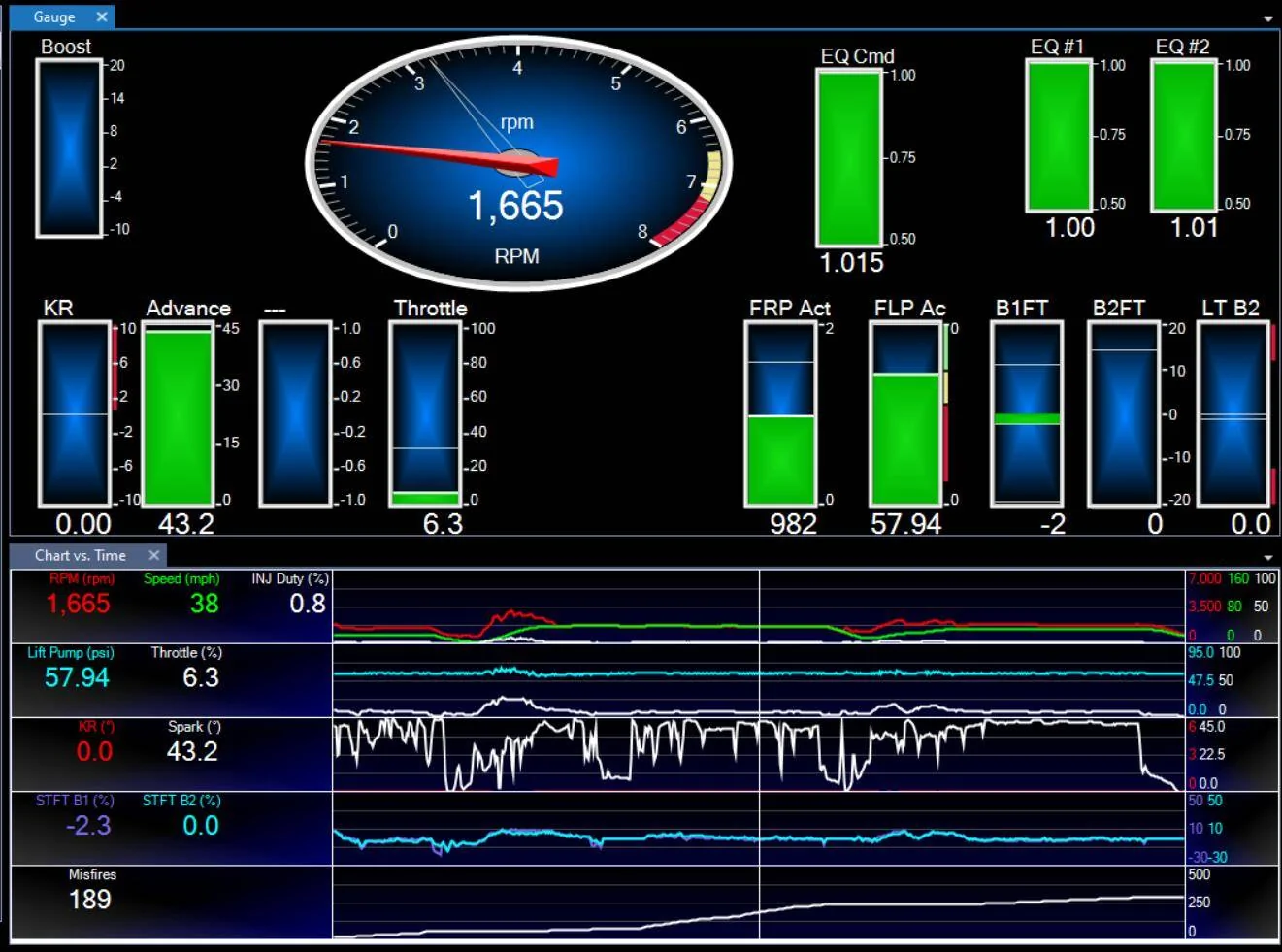

Here is a screenshot from a log of a 7 minute drive just going down the road by my house. Total of 463 misfires logged in that period and all in the conditions seen in the screenshot below.
Nothing really jumps out to me as abnormal. If I hadn't had a CEL, I actually wouldn't have a clue anything was even wrong. So far, I have not felt or heard a misfire, the car idles fine, and during the times when the misfire count is actively increasing, I can feel nothing abnormal in how the car is behaving.
  • Around 5-8% throttle
  • Fuel trims are all within 2%
  • Fuel Pressure looks normal

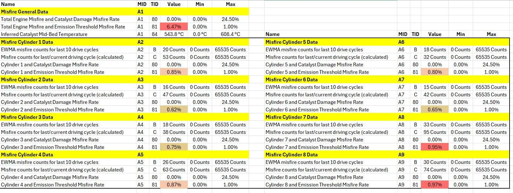

Mode 6 data from this drive. I think I only have 2 short drives after the tune reflash so no codes yet, but it is right at the threshold.
Based on what others have posted with a generic P0300, it seems like some have had issues/success with the O2 sensors, Crank Sensor, and IMRCs (still applicable on the 18+??) as mentioned before. I just don't want to keep throwing parts at the car if there is an intelligent way to go about diagnosing this.
