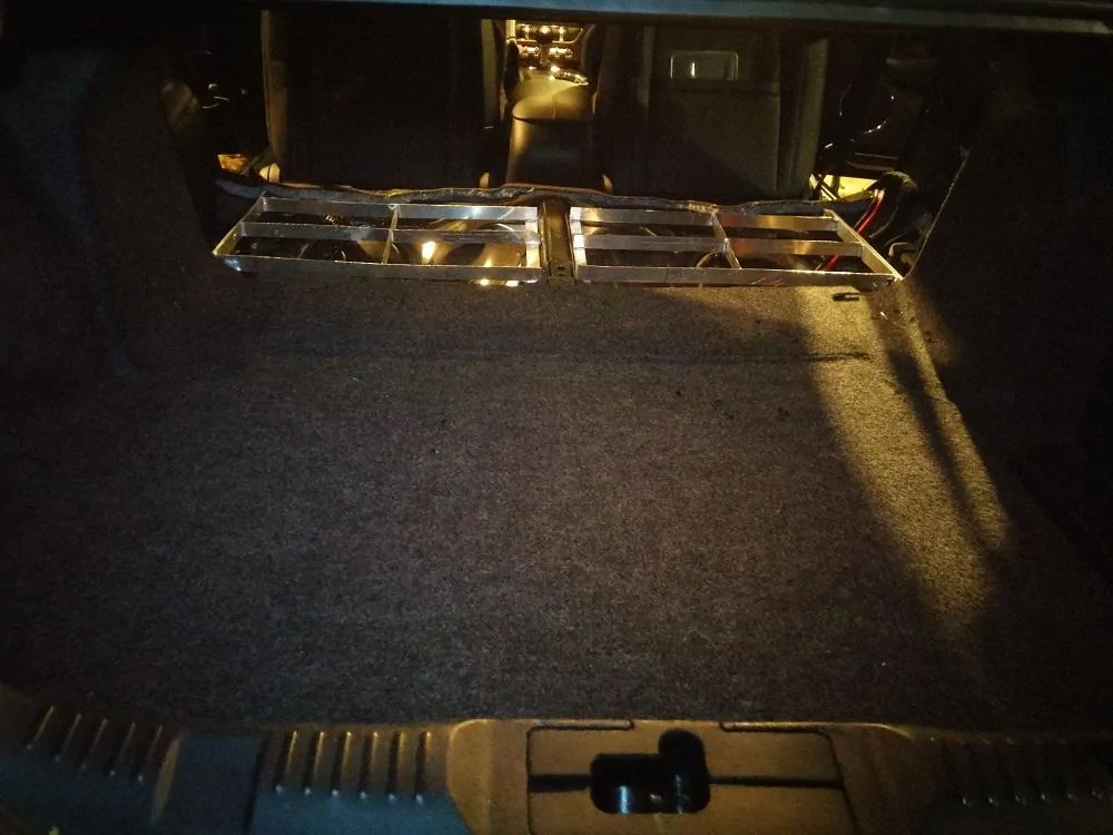

I would think that ALL interior would have to be gone including seats and only have 1 CF race seat. For example, all the trunk material is only 10 lbs. I would also think that every exterior panel that can be removed would have to be replaced with CF.

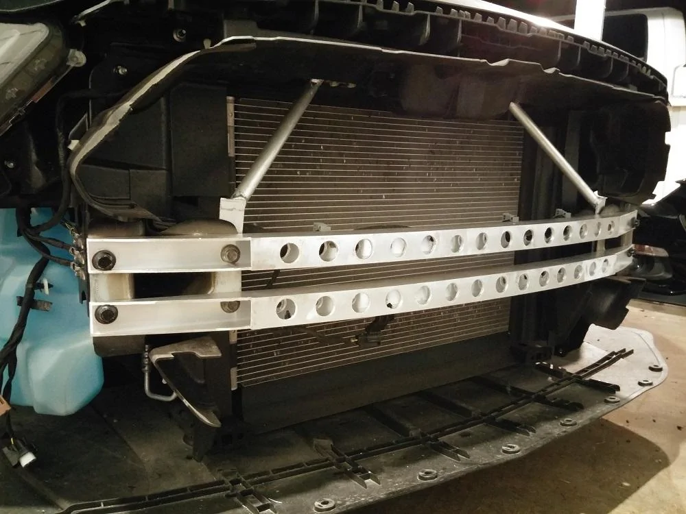

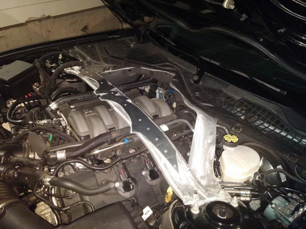

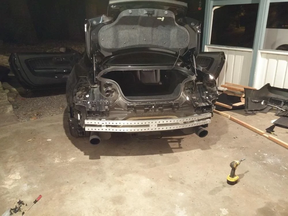

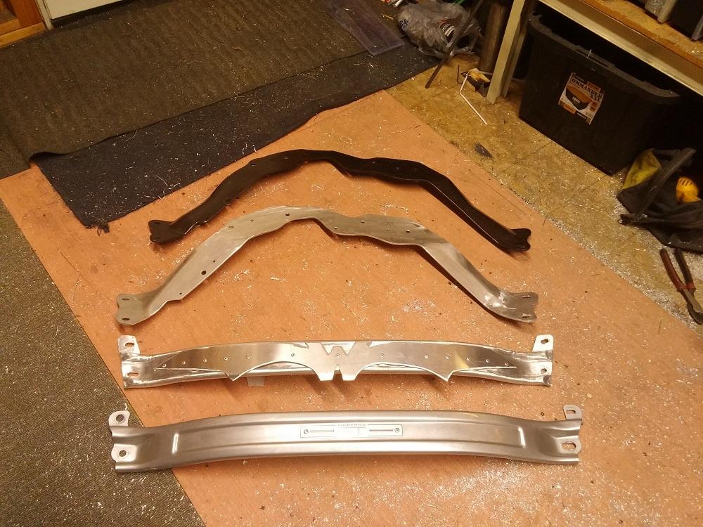

I Fell off the bandwagon. I got preoccupied building a new shop and running electrical. BUT I have purchased all the Aluminum I need to finish up the Radiator support and it has just been sitting until i had some free time.
But as of right now this is the plan.
Radiator support in aluminum
2pc rotors
CF DS
Carbon Doors
Thats where i'll be done.
I'm Think i'm only going to be getting it down to high 3500's. I want to redo the front fascia Eventually with my own custom thing once the new mustang comes out. Pretty much figured if I want to go any lighter I'm going to be spending the same amount of money as the Twin turbo kit I want. And TT will win the vote.

That's some nice fabricating you did there.

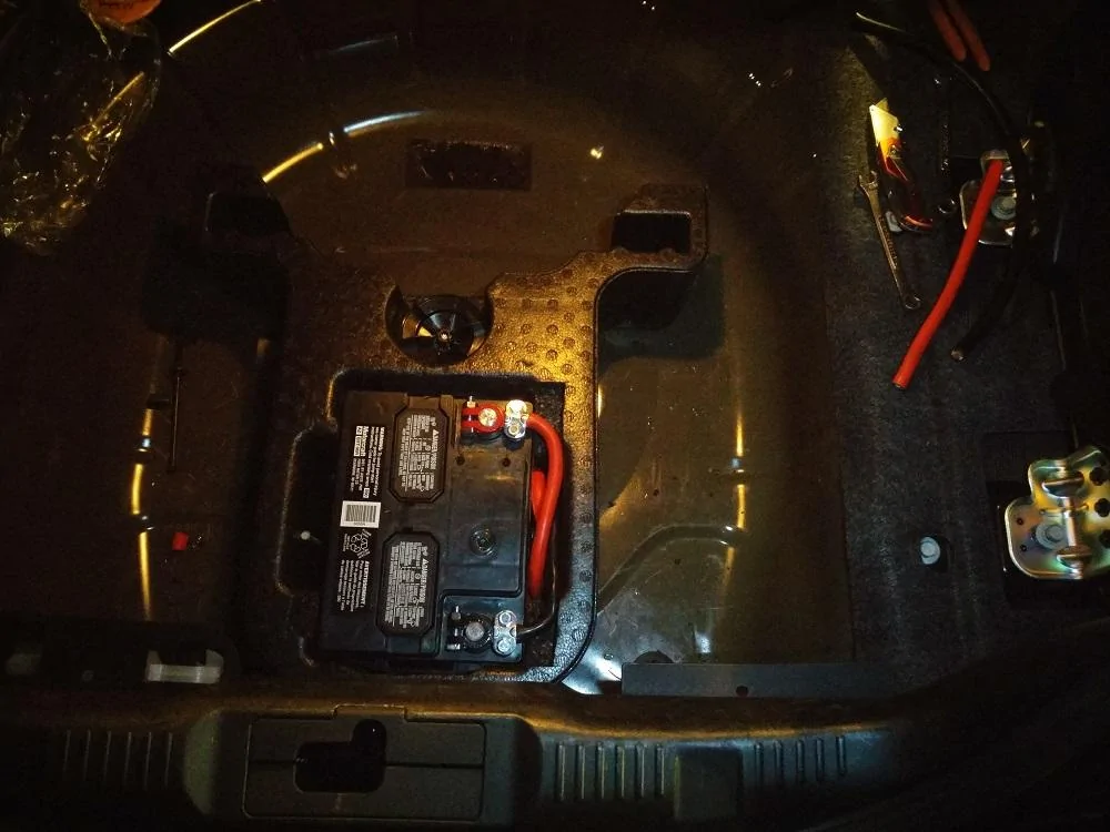

Braille battery weighs 9 pounds.
Technocraft T3 seats are 6 pounds each.
I thought about the Light battery option but seeing how its in the trunk I'm not too worried. That might change as I used 0ga and it doesn't seem to be enough to crank the car when cold. its really slow and I fear eventually will cause premature starter failure.... I'd assume the Braille's have less capacity/cranking amps?
