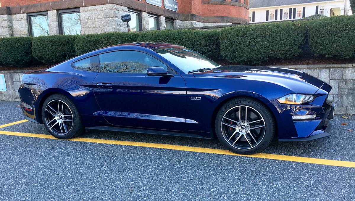

FWIW, I drive my car in the winter but have a 4x4 Tacoma for bad weather days. So for me, I went with a set of Michelin Pilot Alpin 5 winter performance tires (245/45-R19 on all 4 corners) on a set of Ford Performance 19x9 Boss 302 wheels. It was a bit spendy, but I've never regretted it. If I didn't have the Tacoma, I would have gone for the Blizzak WS snow / ice tires that I had on all my other cars since 2007.
And, the Boss 302 wheels look decent as well:
