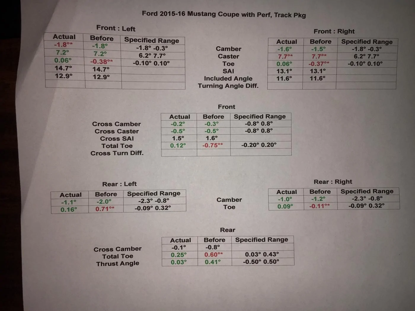

Just got my alignment done after installing the cb005 from BMR. I am lowered on Eibach Pro springs. My prior alignment ate up the insides of my front tires.
Do you see any issues with how they set me up this go around? This is a different shop.
