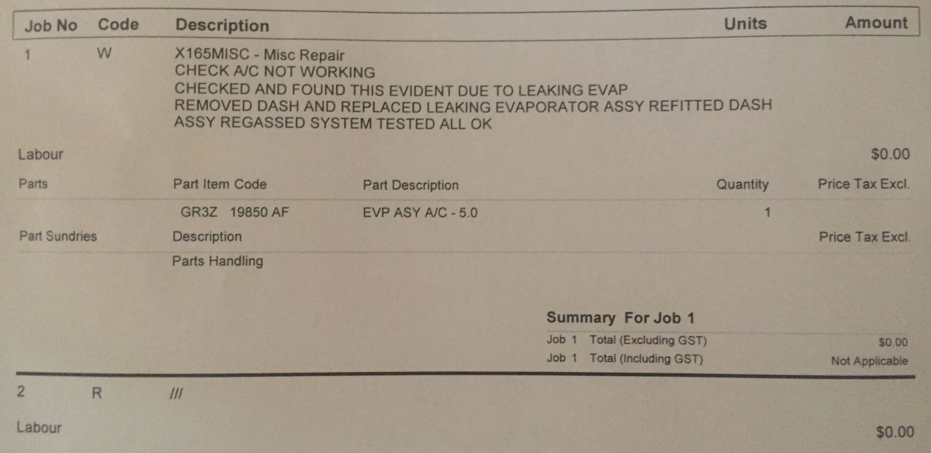

So is that a new part as opposed to the original faulty part? Sorry I don't know what the original part number was.Well, that went rather smoothly.
Gave it a good looking over - no damage whatsoever that I can see and all lighting etc. reconnected properly.
No new rattles detected on my short drive home.
Oh, and the air conditioning is now working perfectly.
:clap2:
Part number of the new evaporator assembly is: GR3Z 19850 AF.
I'm assuming it's a revised part - I have no idea what the original part number was.So is that a new part as opposed to the original faulty part? Sorry I don't know what the original part number was.
Seems that there has been an evolving change in part numbers @trumpeteer_au .So is that a new part as opposed to the original faulty part? Sorry I don't know what the original part number was.

Well got the car back and all seems well. It's working and no rattles. Same part number as you [MENTION=7882]Drewbo[/MENTION]Best of luck tomorrow, @trumpeteer_au !
