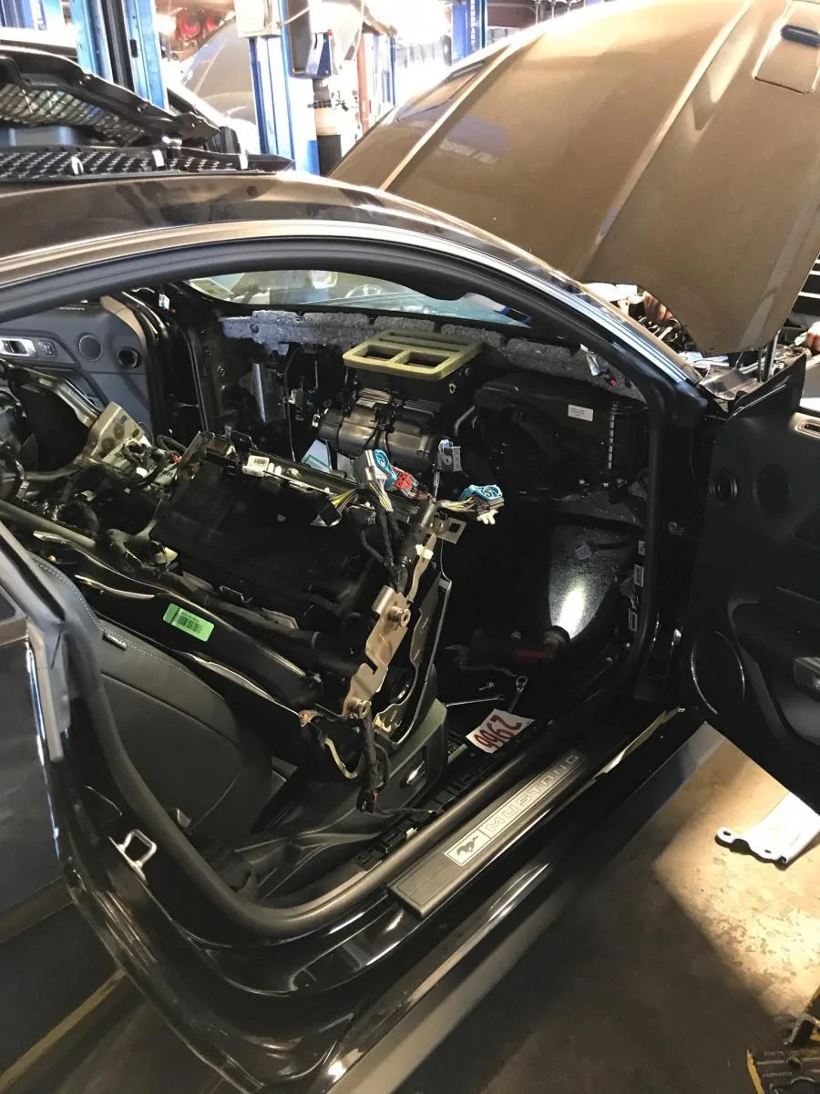

My car is going in tomorrow for the dash removal/evaporator replacement.
Please forgive me for my sudden bout of trepidation.

Not many stories of botched repairs for these AFAIK Drew but I understand every bit of your trepidation. Nice photo, shame they forgot to put protective seat covers on, thoughtless pr*cks.

yes its a frightening photo, almost obscene, but mine emerged from the surgery in perfect condition, so just hope yours is not the 1st one the dealership has had
And mine goes in Tuesday next week, but the dealership assures me they have had plenty of practice.:amen:
Yeah it's sickening. I've seen a photo of another dash removal/evap replacement where they actually removed the seats and centre console.
I don't blame you. Just hate to see that Will keep all fingers crossed mate.
Thanks!
They've done several already - including a local M6G member's car which had a positive outcome.
Here's hoping - it's probably in pieces as I type this.

OMG!!!! WTF!!!!!! This is absolutely atrocious treatment of a near new vehicle?
FORD has totally dropped the ball on this and should offer you a brand new Mustang instead of ripping yours apart like this. Storing parts on the roof is not acceptable.
I would not be accepting this and going straight to the ACCC. Do not accept this bullshit.
#lemonlaws.
MaxQ
Nov 11, 2015
294
657
Australia
2016 Oxford White 5.0 GT
#lemonlaws.
I think you'll find the picture used is of a LHD vehicle, not an AUS vehicle.
by the same token not a good look to store parts on the roof.
