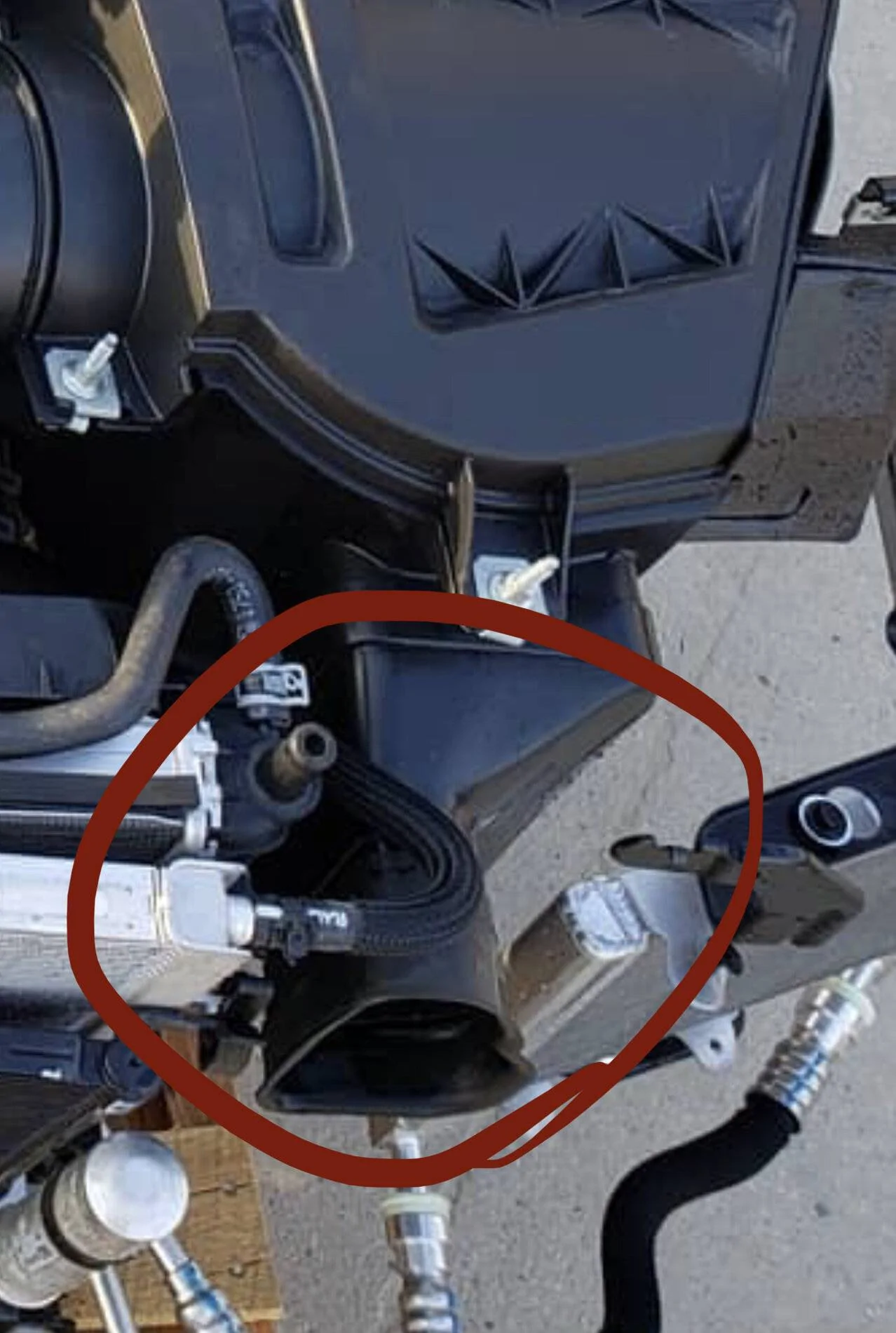

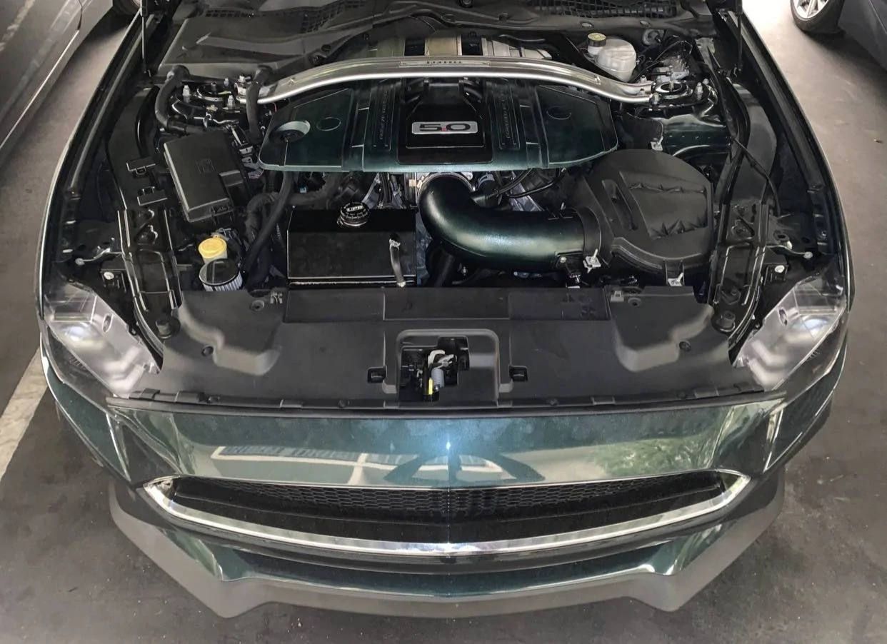

Anybody happen to know the part number to this "snorkel" piece? I ordered the GT500 airbox and cover to help keep the IAT down for my JLT intake. I saw somebody do it, so I wanted to give it a try.

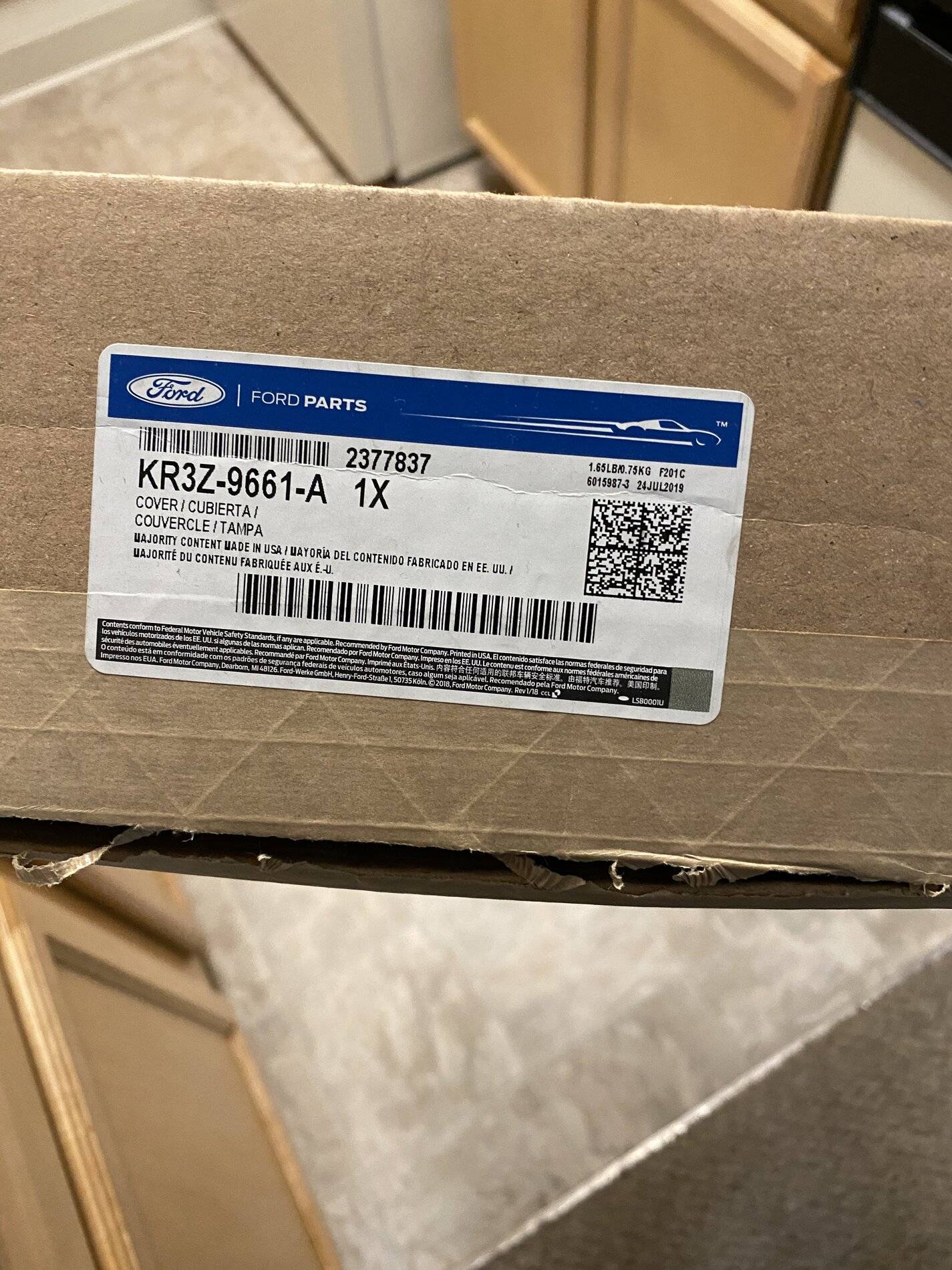

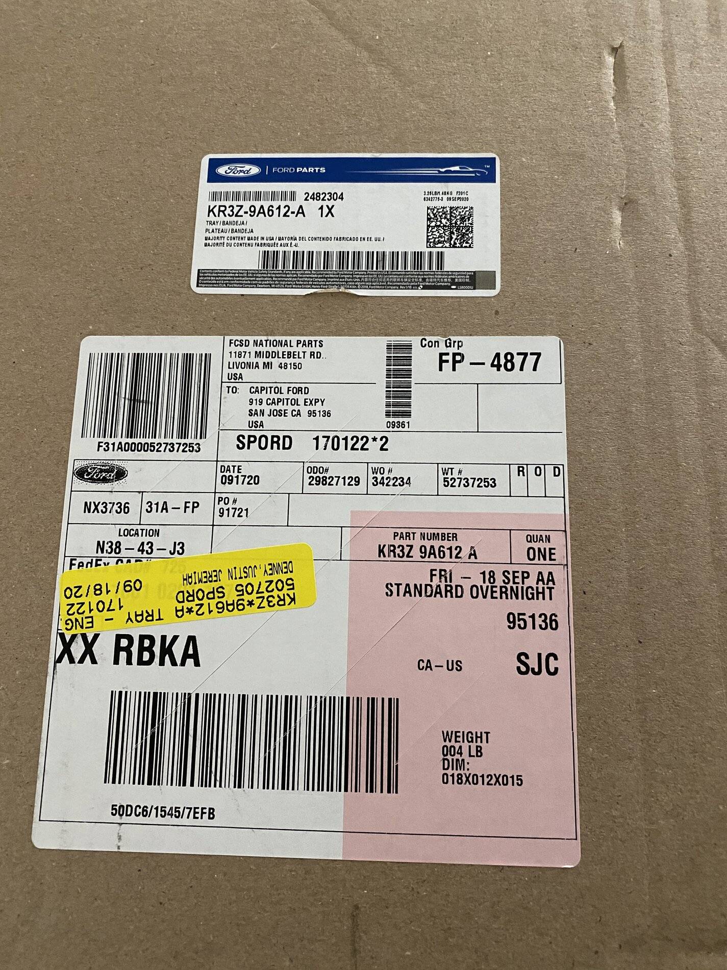

I ordered it from my local Ford dealer. I just asked them to order the airbox assembly which I thought would come with the snorkel but it didn't.
Here's pictures of the boxes with the part numbers, I think I remember paying about $200.

Thanks. That’s awesome!
What JLT intake do you have? Does the intake pipe fit into the box? Have you tried yet?

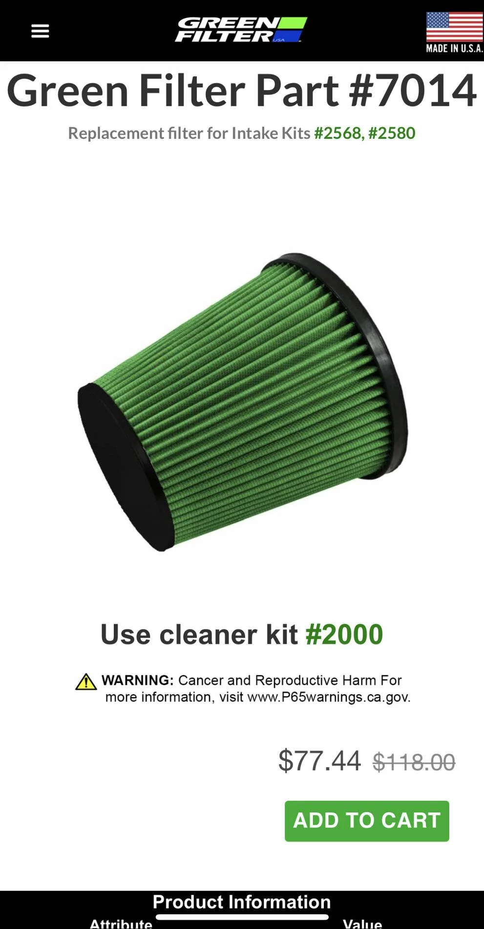

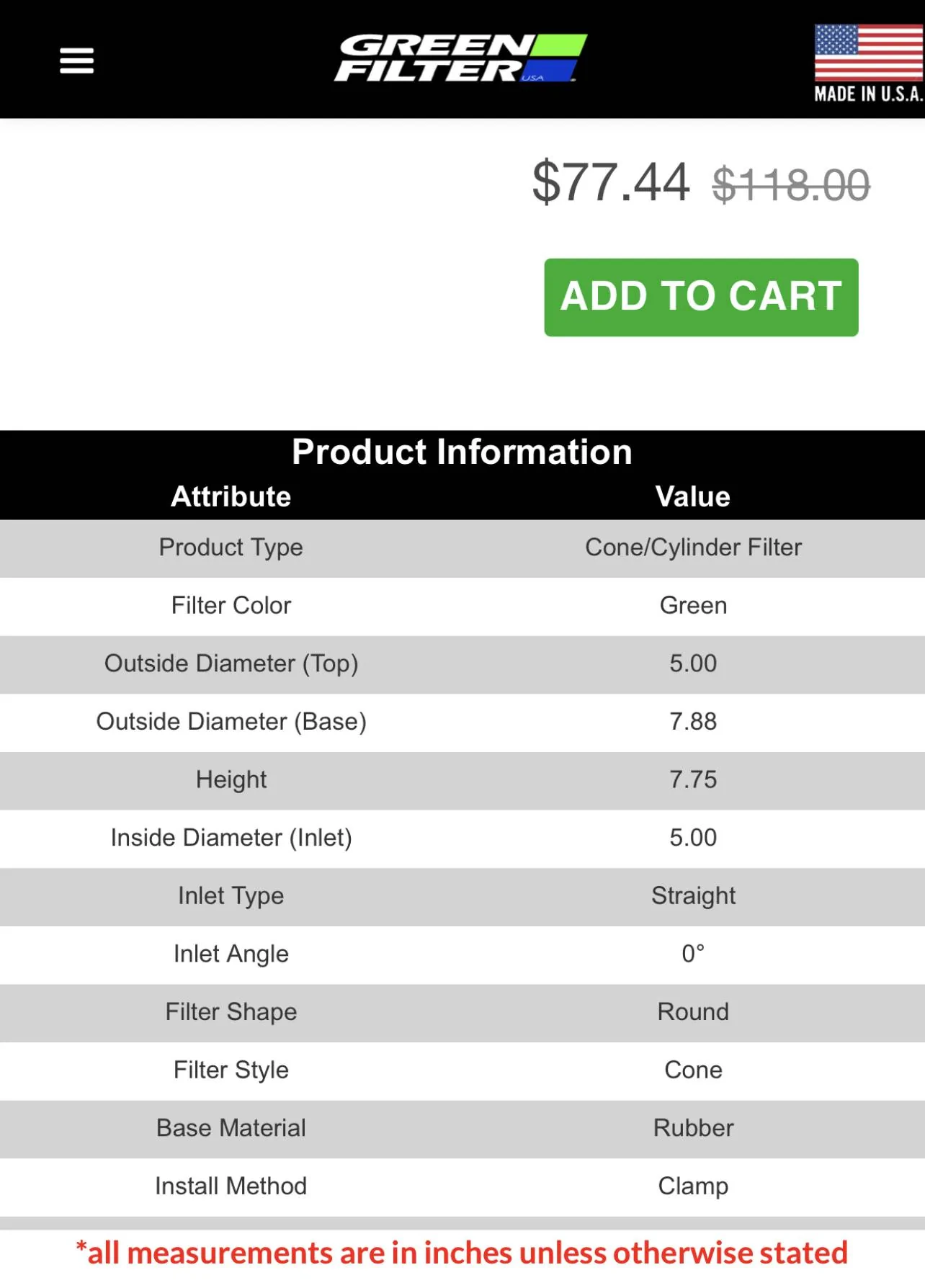

I have whichever fits the 2018+. Everything fits except the air filter that comes with the JLT. You'll have to buy a slightly smaller one, but it's hard to find one that's a bit shorter that will still fit the huge opening of the JLT. This will fit:

You’ve given me a good idea with that GT500 air intake. Thank you.
Final question and then I’ll stop derailing this topic: did your JTL require a tune? Mine required a tune and I’m curious if a shorter filter would effect the tune.

Yes, it requires a tune. The filter won't affect the tune at all, but if you have concerns you can install the new filter and send data logs to your tuner so they can take a look to see if any changes are necessary.

Can you do me a favor and see if there is a part number on the part that I'm asking about? I doubt it, but it's worth a shot.

Is this the part you are looking for? You can copy/paste it into google to check.
FR3Z 9F763 B

Yes, I'm not sure it will fit the airbox for the GT500. I tried to use the OEM part from my 2018 and it didn't fit.

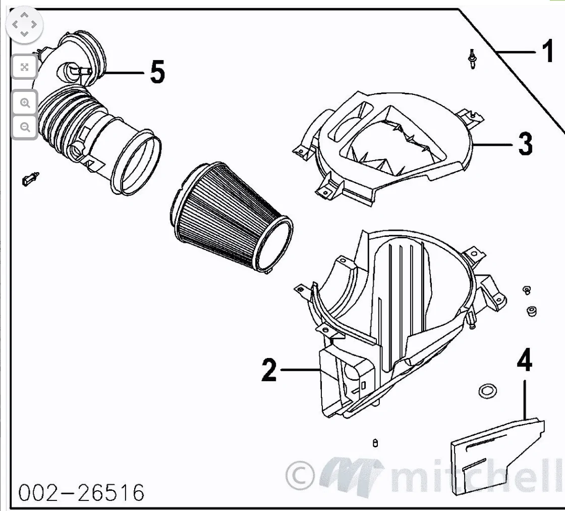

I just realized it was for a GT500.
Unfortunately this is the only diagram i can pull up. It doesn't look like it shows the piece you need, only the box.
