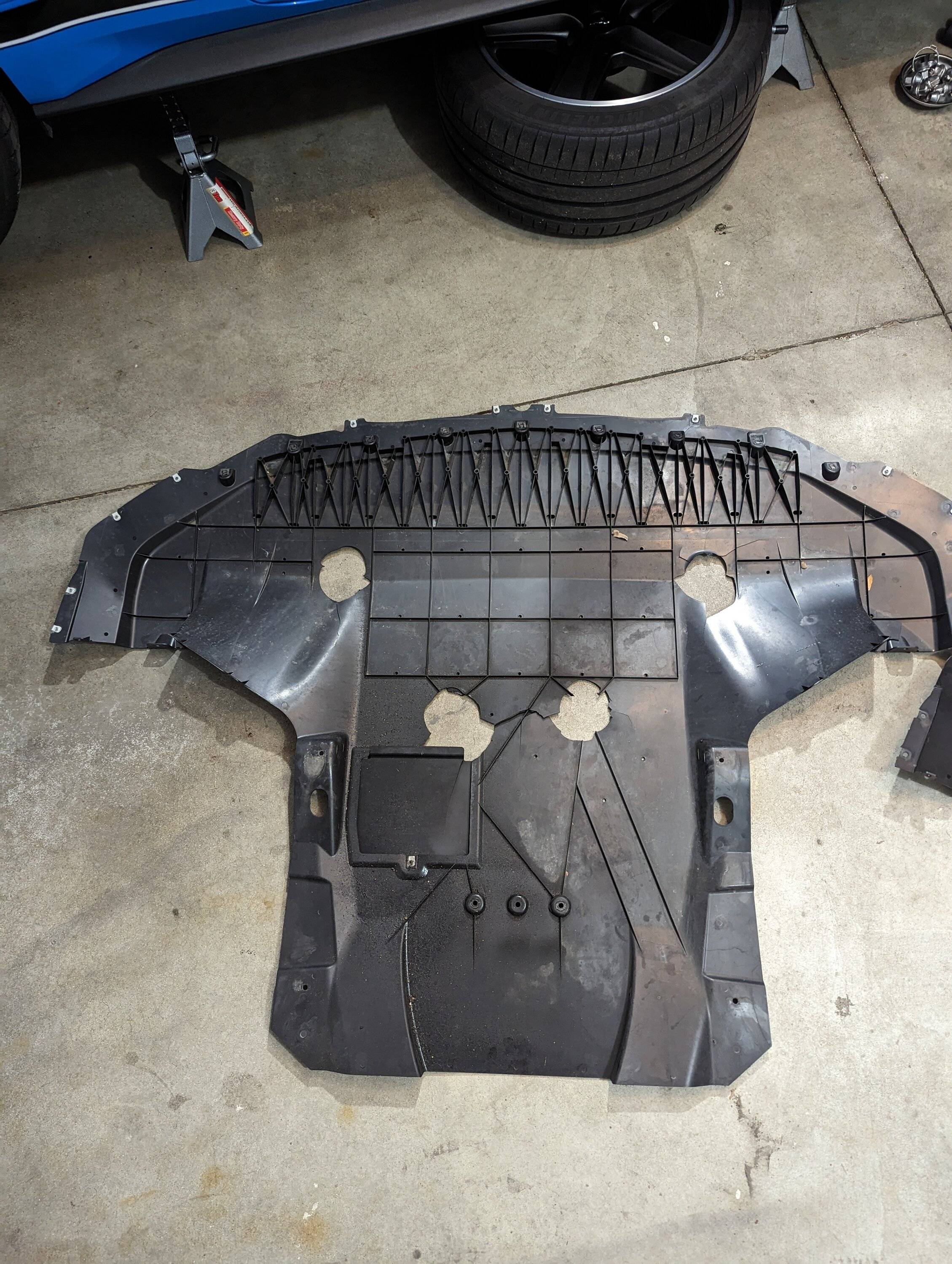

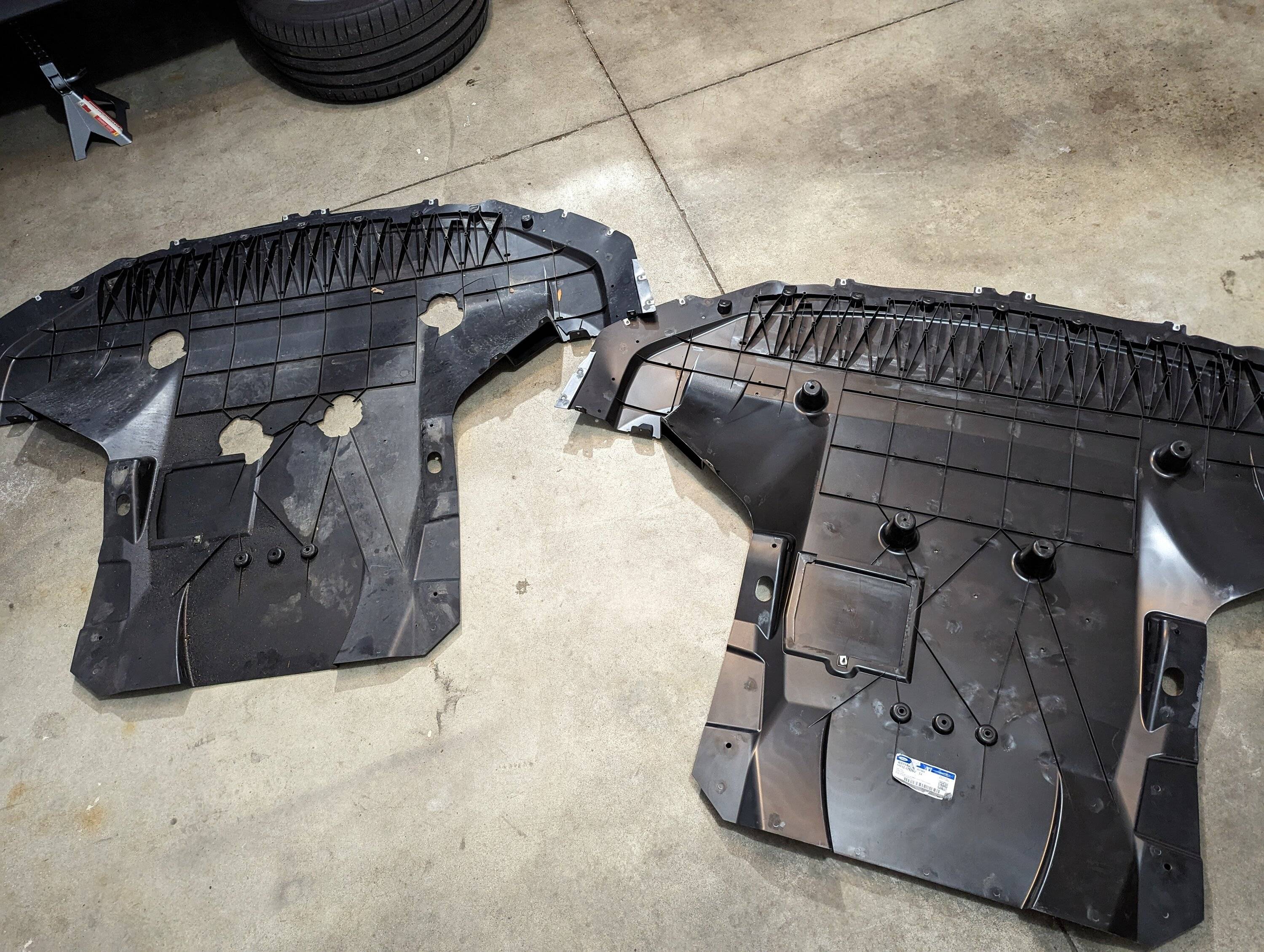

For those thinking the Mach 1 can handle a jump, expect your "Stone Deflector" to be damaged.
My rear must have been 3-4 feet in the air LOL. I was worried the rear shock mounts would be damaged, but they seem fine. Really the undertray was cracked in pieces and the center posts sheared off. I landed front first/nose down, probably why only the front skirt was damaged.
For those who experience something similar, the Mach 1 under/skirt tray or "Stone Deflector" is Part Number MR3Z-17626-A
About $300 at your local stealership

No screws came with except the one for the oil filter cover hatch. The metal inserts on the front that the screws go through are included yes. The first picture shows exactly what you get.

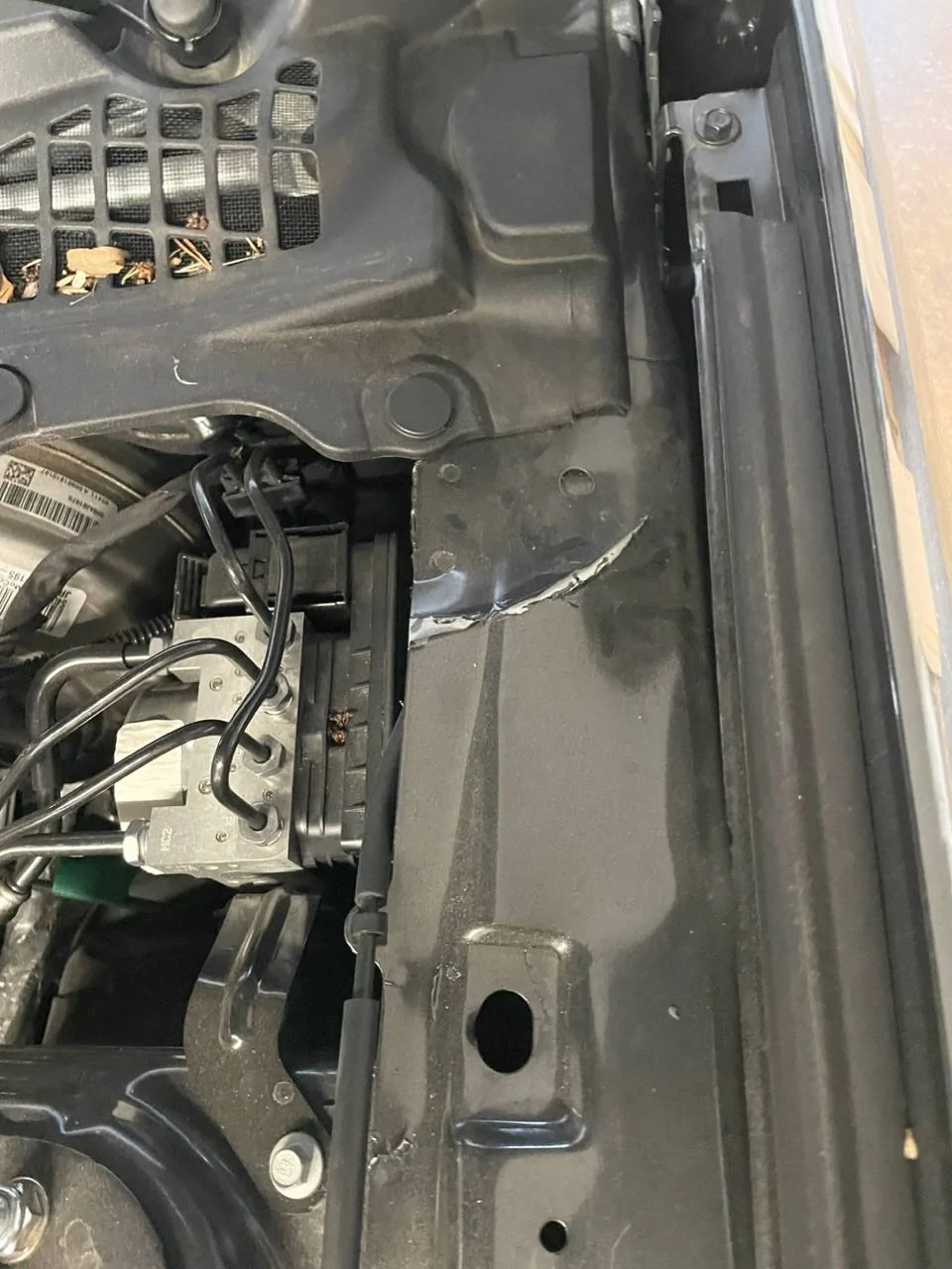

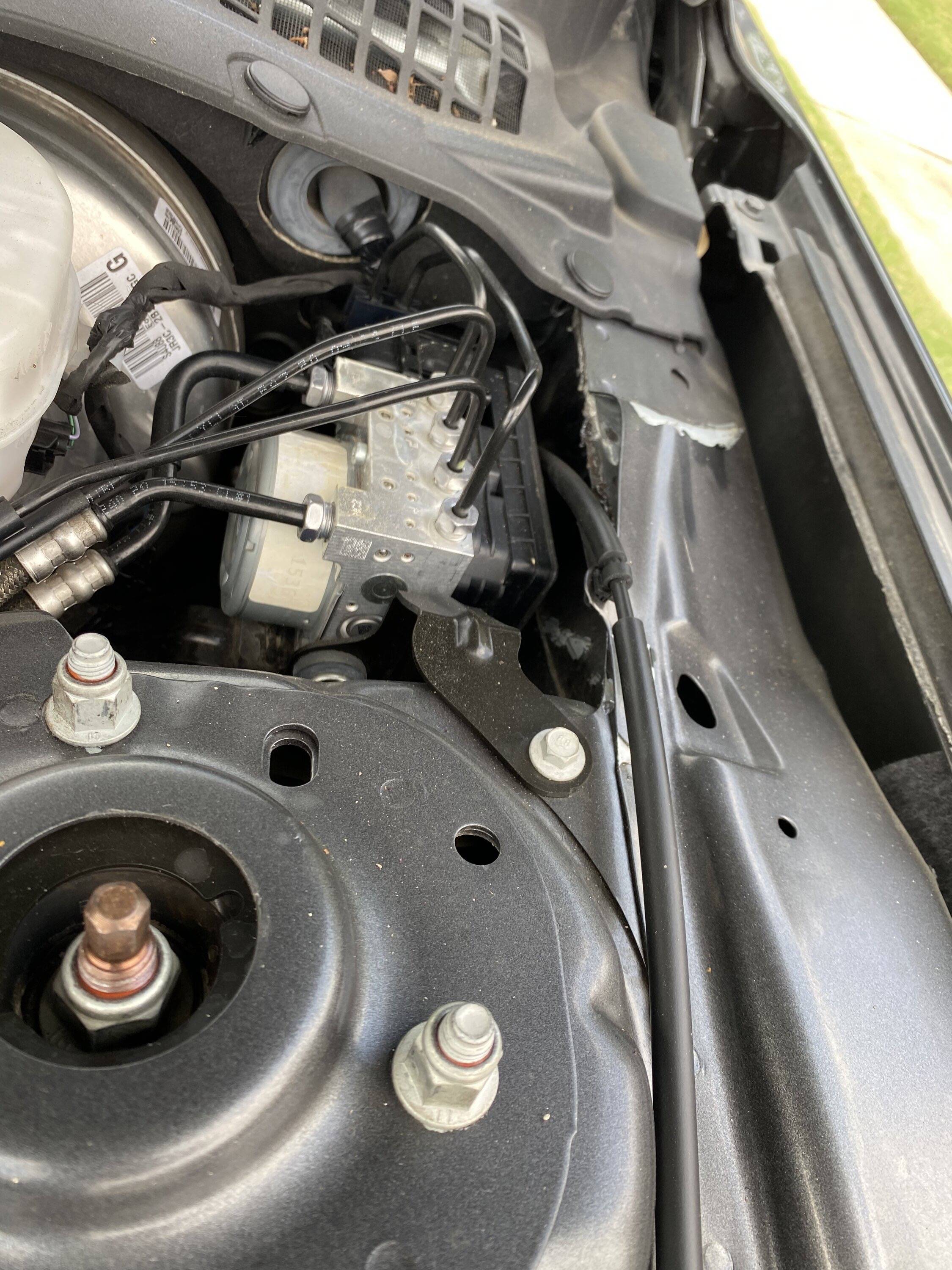

@Hifiguy - Just check your inner wings …
These are different cars (its just a coincidence they are the same colour) :
One hit a pot hole and the other a mud banking. I don’t think the pothole car had any other visible damage, the mud banking car (at first look) appeared to just have superficial bumper and splitter damage.
Hope yours checks out OK :like:
WD :like:
I am a bit lost, what is the damage I am looking for?

Inner wing is nice and flat, thanks for the tip! Must've been a huge pothole/bank for it to yield like that in the pics.
