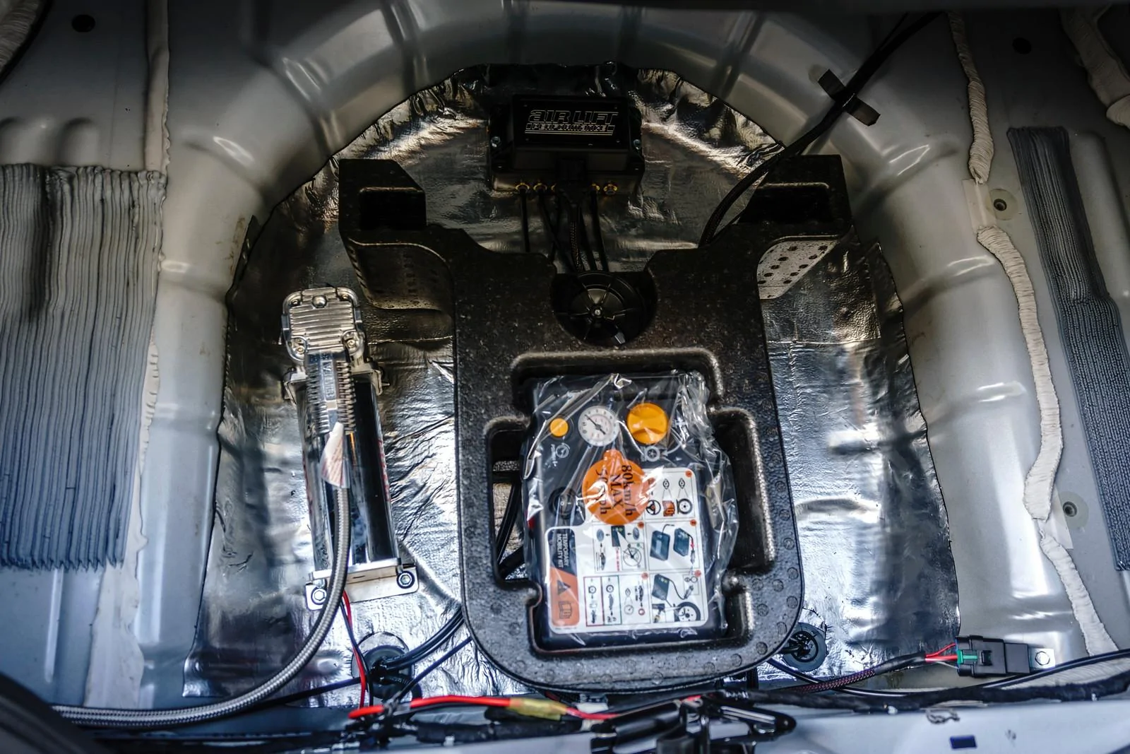

I mounted all my components, less the tank, in the spare well and upright on the isolators. Left room to add another compressor over the winter. They fit just fine in there; I have seen the compressors mounted sideways, though.

Have any pics?

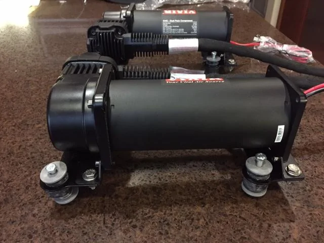

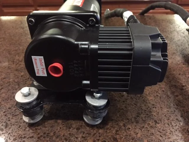

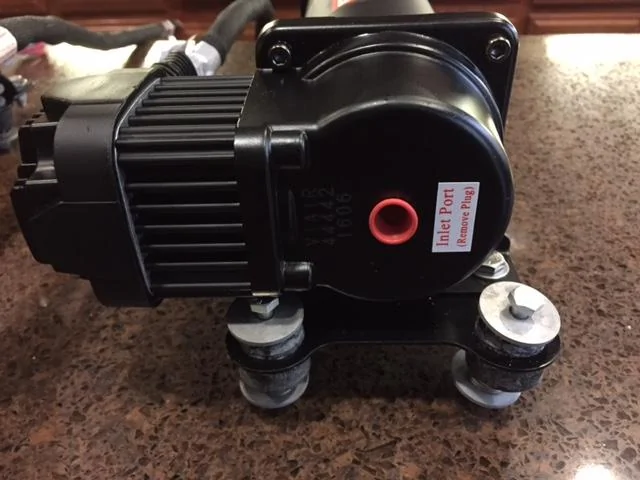

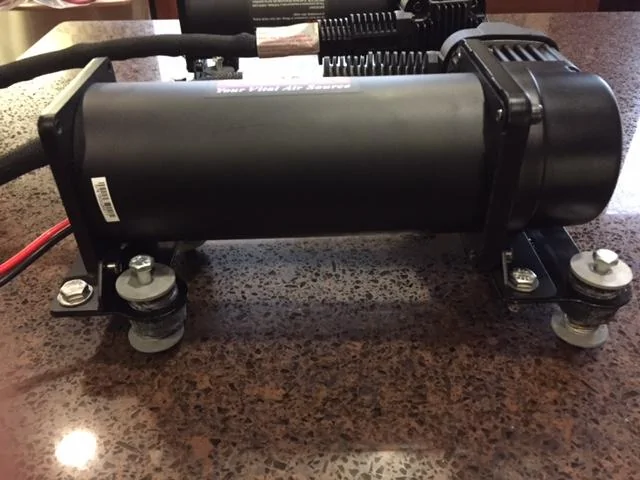

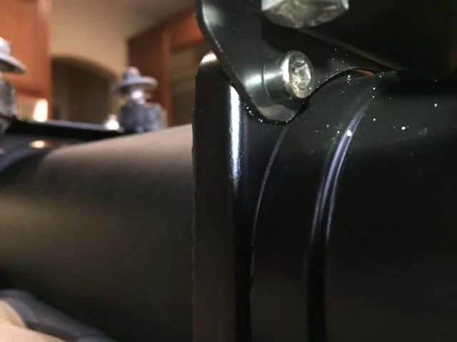

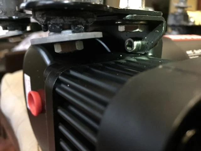

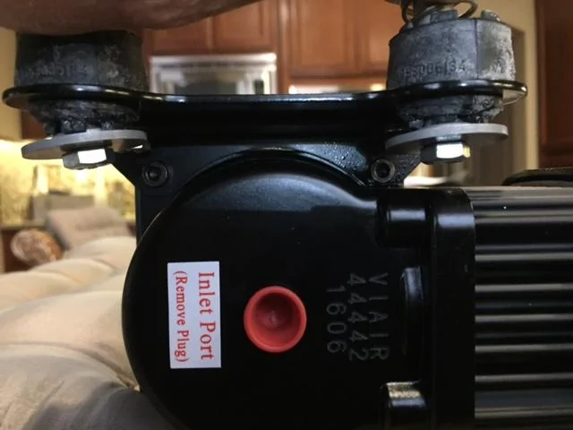

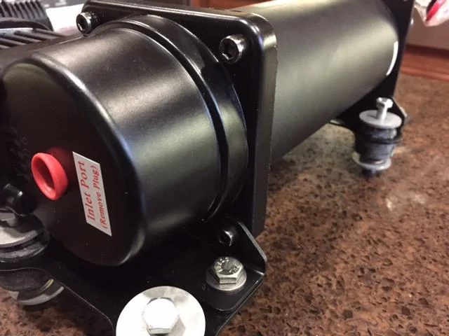

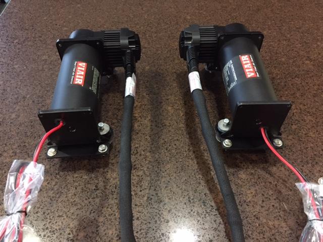

Well, after looking at more pics and talking to VIAIR, I was able to get the compressors on the isolator kits--sideways. I removed the mounting bases (the ones with the small allen head screws that come with the compressor) turned the compressors on their sides, oriented for my set up, and then reattached the bases to the compressor. Only issue IS... you have to trim about 1/8" off of the ear of the mounting bracket to get it to fit back on the compressor body. Only one ear needs to be trimmed(the one that goes closest to the compressor fins).
You also need to be aware that the small allen screw positions need to be switched, because there are two sizes. Long and short. Longer one is used with the bracket. No bracket=shorter screw.
Then I attached the hardware from the isolator kits to the bases....and voila!
Everything worked out well. I'll try to post pics.

Here's some pics

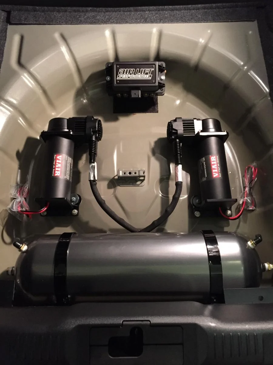

Terminated, what size compressor is that? In an upright position, with isolator kits, my compressors were 2-3" higher than the carpeted wheel well cover????
Like how you routed the leader line to the tank, from the Compressor. How long is that line and where did you purchase it?
It's the Viar 380. Worked perfectly for standing upright in the spare well. I think the 444 is bigger though, so that's probably the difference.
Guess I should've done more research and gone with twin 380's. There's just so many different ways to set it all up that there's really no guidance when purchasing the systems. VIAIR rep said mounting sideways won't hurt the Compressor, but the manual states that it may shorten the life of it because of the weight on the piston and seals. Oh well! We shall see.
