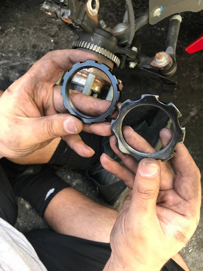

Hey guys I just wanted to give everyone a heads up. Air lift updated the locking collars on the front struts about 6 months ago. I bought a kit that had been sitting on the shelf a while and when I installed it my front wheels locked up agents the collars. I have roush wheels 20x9.5 47.5 offset. So I contacted air lift and the sent me the new low profile collars. I thought I would share in case anyone else runs in to this.
