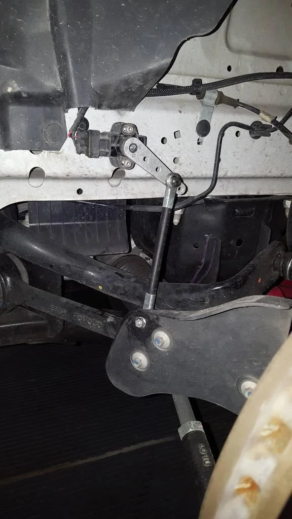

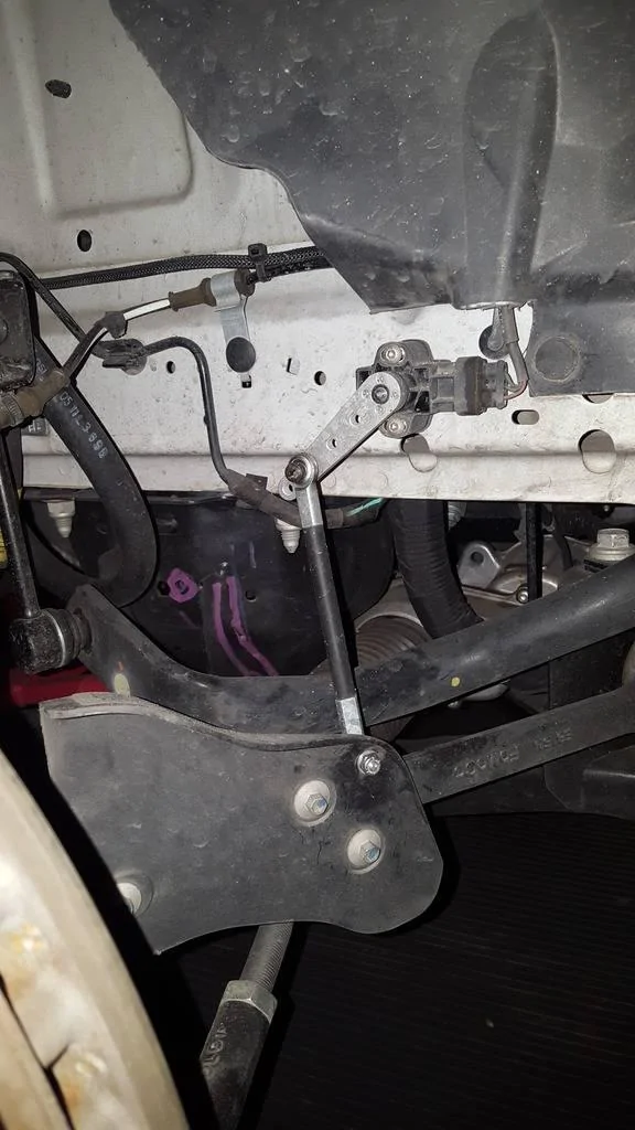

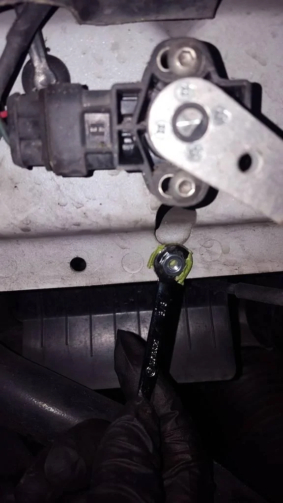

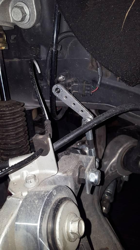

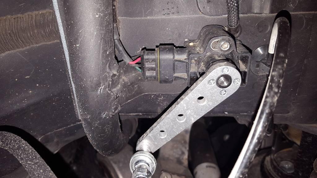

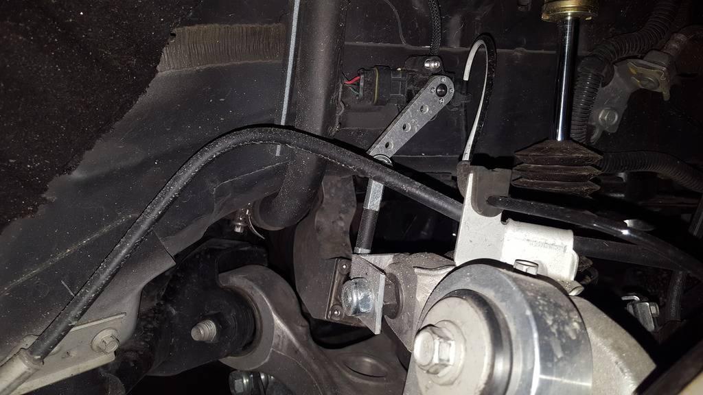

These aren't the best pictures but should suffice in showing the locations where I mounted my sensors. Do note for the front that I mounted the linkage to the brake air duct attached to the control arm. It shouldn't be hard to make a aluminum bracket to wrap around the non-PP control arms however.
Notes:
-A small 3/8ths wrench was used to hold the nut to be bolted for the front sensors.
-Front wheel liners have to be trimmed where the height sensors are placed.
-The nut for the rear is assessable from a very large rubber grommet that is visible when you remove the trunk carpeting.
-I am using billet height sensors arms, I originally snapped a stock arm and then 3-D printed replacement arms so that I can use them during the 'shakedown' period. I could not justify paying $20 for a OEM plastic arm when you can get 4 aluminum arms for $40.
-I am also using metal heim joints for all 4 corners. I would not recommend doing the billet arms and metal heim joints personally (I consider the plastic heims and arms that come with the Accuair kit as failsafes to protect the height sensor in case of binding or failure to articulate) but I have enough replacement height sensors laying around that I just went for it.
-Use spacers to allow full articulation of the heims so that they don't contact the height sensor arm or linkage bracket. This applies to both the metal and plastic heims.
-Rear sensor arms are flipped 180 degrees. (Unscrew, pull off, reinsert 180 degrees)
-The driver side rear sensor required removal of the gas filler shield/vent tube holder to clear the height sensor arm. I also removed the 10mm bolt holding the gas filler tube to the chassis and used the hole as the lower mounting hole for the height sensor.
-The Accuair heims are 10-32 thread. To cut the thread to length, the easiest and quickest way is using the bolt cutters found on some wire strippers.
-I used 10-32 panhead screws for the linkages to provide clearance.
Rear Bracket
I went through a few 3-D printed brackets for the rear before settling with a simple piece of aluminum angle bolted to the camber arm bolt. The bracket is shown in the pictures and is just a piece of angle sandwiched between the existing camber arm nut and a new nut. Since I have Steeda camber arms, I bought some flanged head class 10.9 M12-1.75 90mm bolts and equivalent flanged nuts so that I can keep the same bolt orientation. (Steeda camber arms requires the OEM bolt to be flipped which would not have let me go with my current bracket setup)
Driver Front
Access hole for 3/8 wrench. Tape is to hold nut (and 'invisible' washer) in place.
Passenger Front
Driver Rear
Passenger Rear
