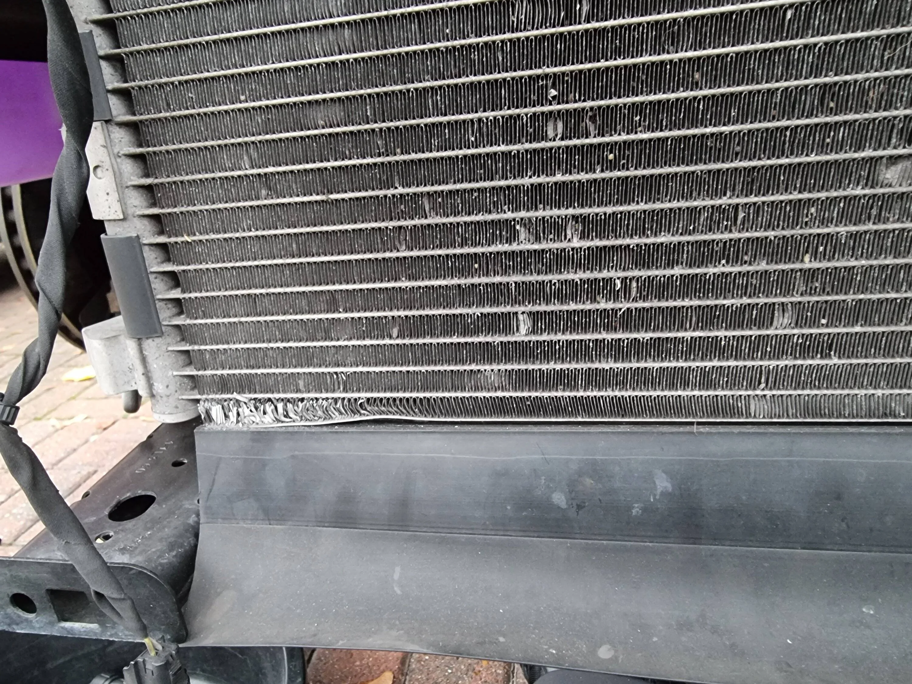

The reason I know is I did a little bit of digging when I saw my condenser had started to crumble away. It's got a lot worse since that photo was taken but luckily my air con is still pretty cold.

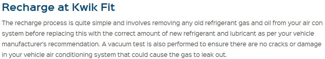

I'm not sure about recommending Kwik Fit, but I found this on their site :

Air con takes R1234yf, which is slightly more expensive. Looks like you can buy 500g top up kits on Amazon for £60, so if they're going to vacuum the system and recharge it for £200, it doesnt sound too expensive.
looking at your rad there reminds me of the time i asked on here about how folks protected their radiators. Some clever cookie said an intercooler, which was funny sort of but just moved the problem forward. Anyhow, yeah doing air con re-gassing best left to someone with the right equipment
