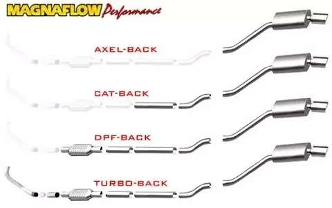

04slosnake does one offer more power than the other? I'm assuming cat back means catted downpipe and turbo back means uncatted
Cat back, or axle back, attaches where your downpipe ends. Turbo back adds the downpipe attached to the turbo. Historically turbo back makes more power, catted or catless.

From the Magnaflow website:
Don't mind the DPF as that is only on Diesels, so cat-back would go up to the section labeled DPF-Back on our cars.
