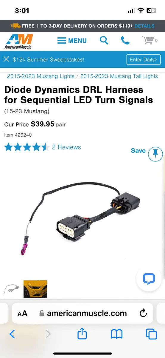

I ended up getting a harness from AM that keeps the front marker lights on with the DRL’s. It only works if you have sequencing front turn signals. Since that keeps the marker part on, my turn signals work without me having to turn the lights on manually. I can leave the lights in auto mode now and not have to run all my lights all the time.

Perfect! I'm about to order that and give it a shot! Thank you!
