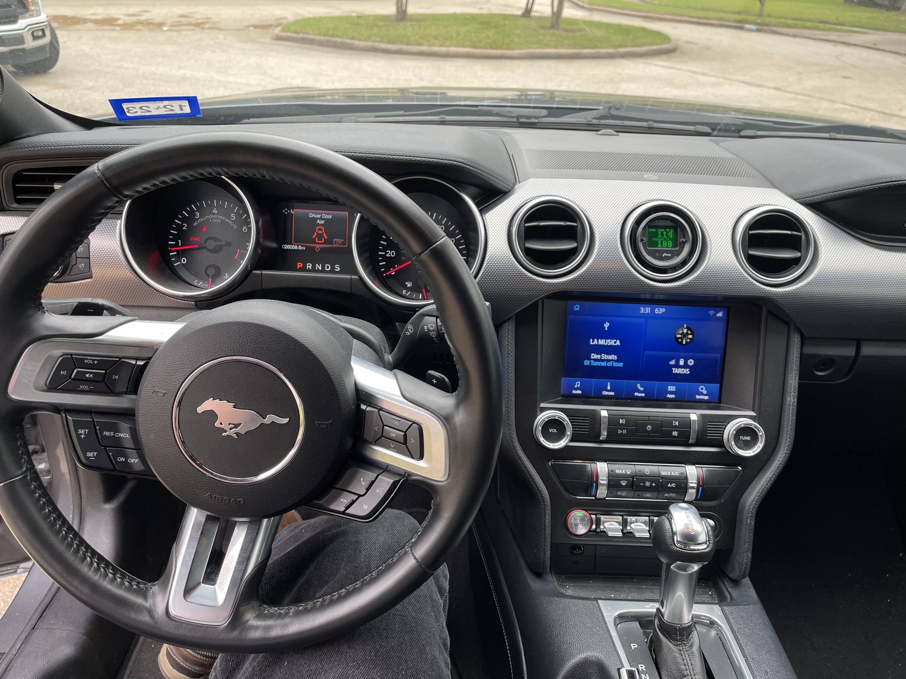

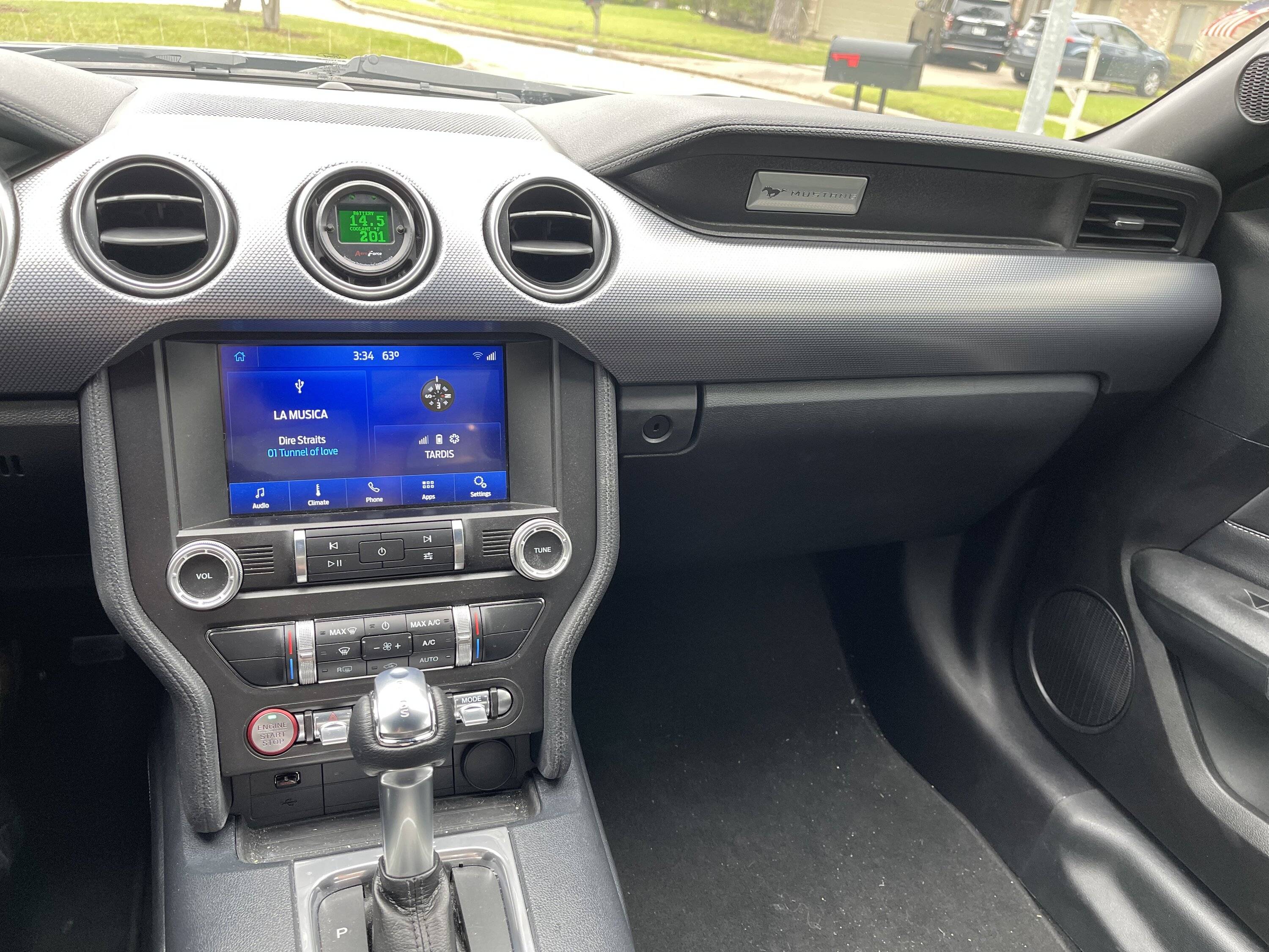

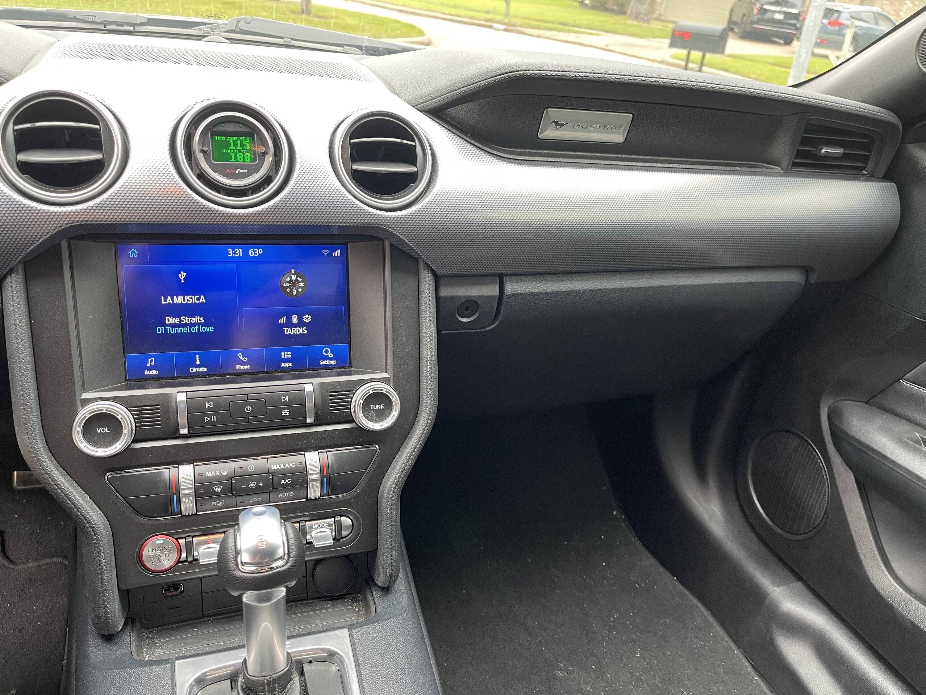

I installed my AeroForce OBDII gauge - I had one of these from 2009-2013 in my 1996 Thunderbird, always liked it, but Have t had one in ten years….instead I had Linear Logic ScanGauge II which was also quite good, but won’t fit too well in this car. I found a long discontinued center vent gauge pod, and finally Decided to use it.

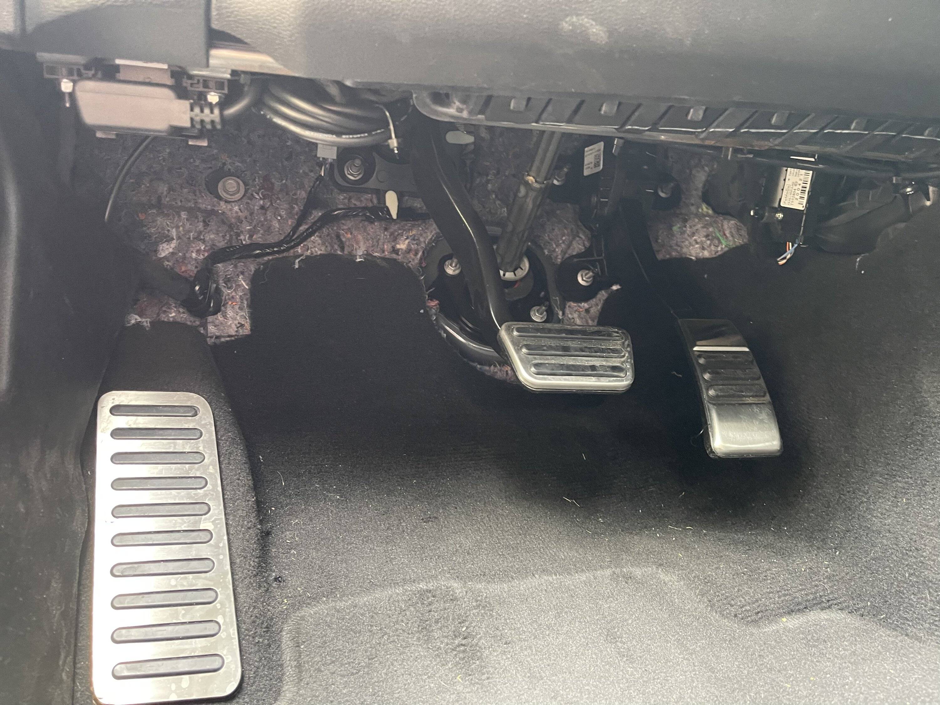

I drilled a hole in the LH side of the center gauge duct to run the wire for the gauge, and I covered the back side of the center vent housing with felt backed tape, cut a small hole to run the wire for the gauge into the vent. I was able to route the wire up through the dash on the LH side of the radio, and everything is zip tied pretty nicely under the LH side of the dash.
