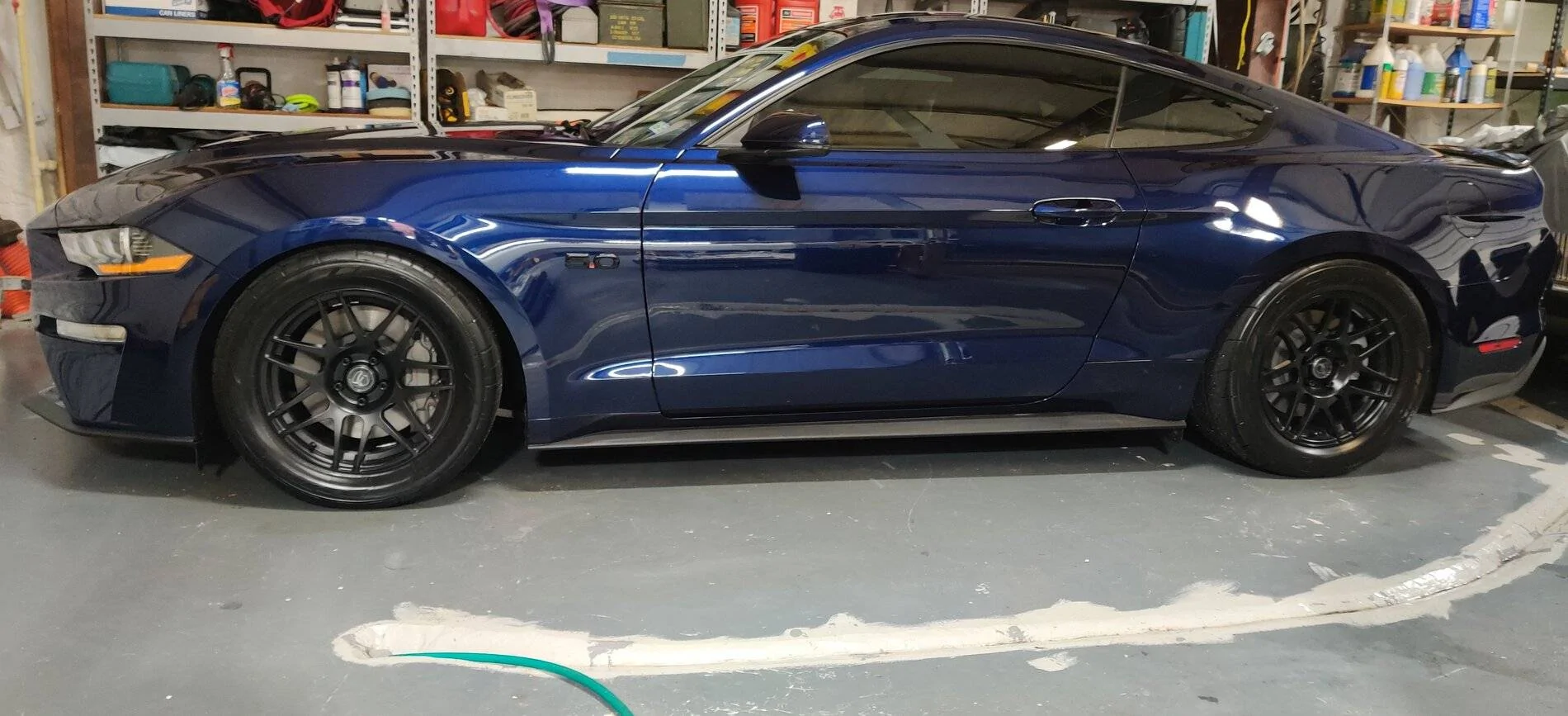

F14s, but did 17x10 and 17x7, street driven no issues at 80mpg on corners. I don't go into corners rated for 30 at 80, but normal highway driving (well maybe a little bit fast) no issues. I didn't want runners but wanted to save a little weight, good compromise for a street car. I am running the tires you are planning on running.

I had 800 wheel. Ran 235 up front on a 17x7 and a 325 out back on the 17x10.5 F14s. I assume the specs are the same for the forgestar F14s as the D5. That set up worked well on the street & at the drag strip.
