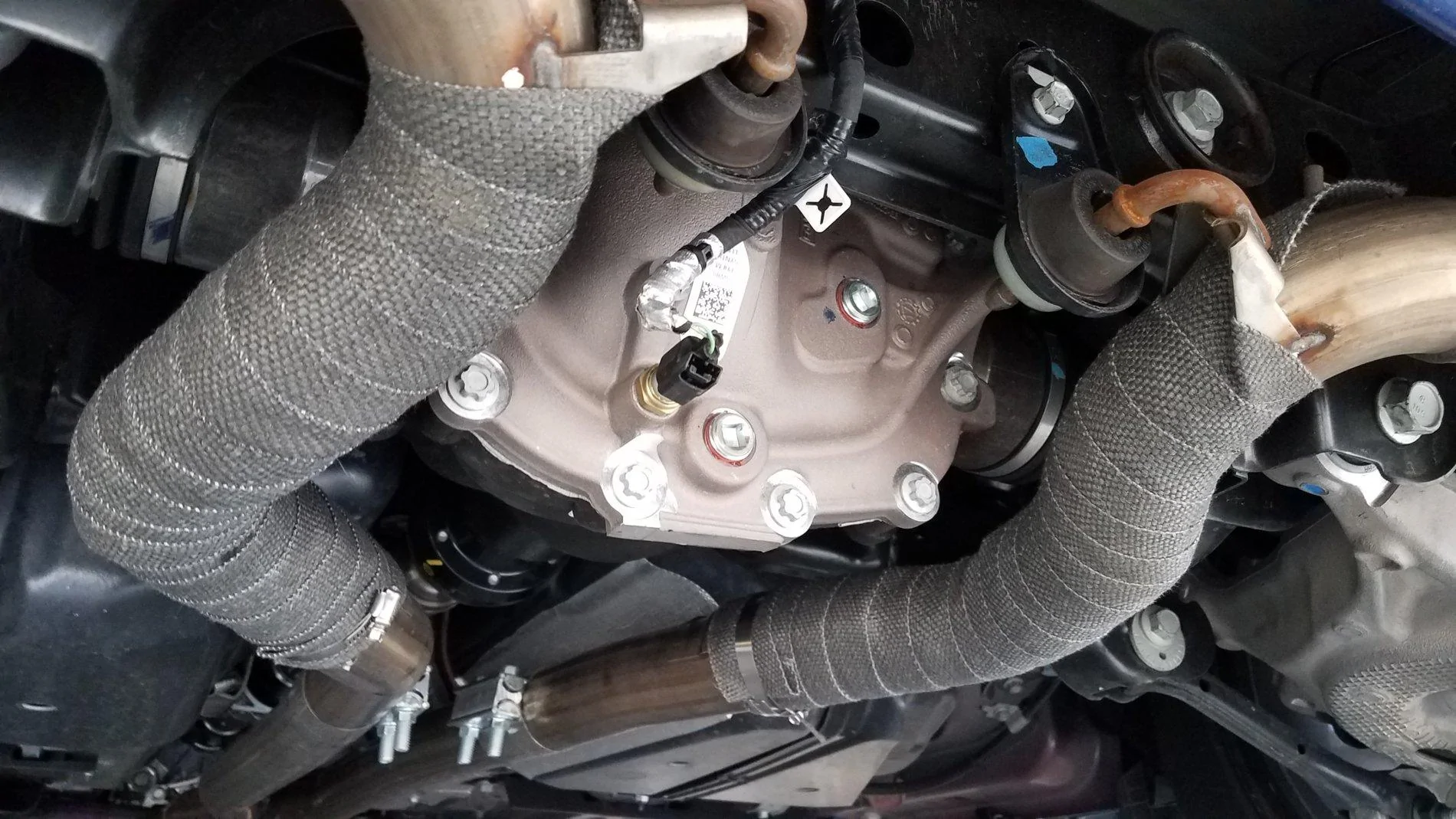

If it starts getting too hot a warning message will come on on the center screen telling you that the trans or diff temps are getting too hot and aak you to slow down.
When that happens just bring it into The pits.
On my day that didnt happen till my last heat where I had alot more confidence in the car and was driving the wheels off it...

Also, this time of year the rear end over heating should not be a big concern. In 95 deg heat my differential over temp light did come on between 10 and 15 mins of pretty hard driving. By the next track day I had wrapped the exhaust pipes with header wrap. I wrapped them from where the pipes start to separate to go around the diff. to the mounting hooks for the pipes. So far no more light.
